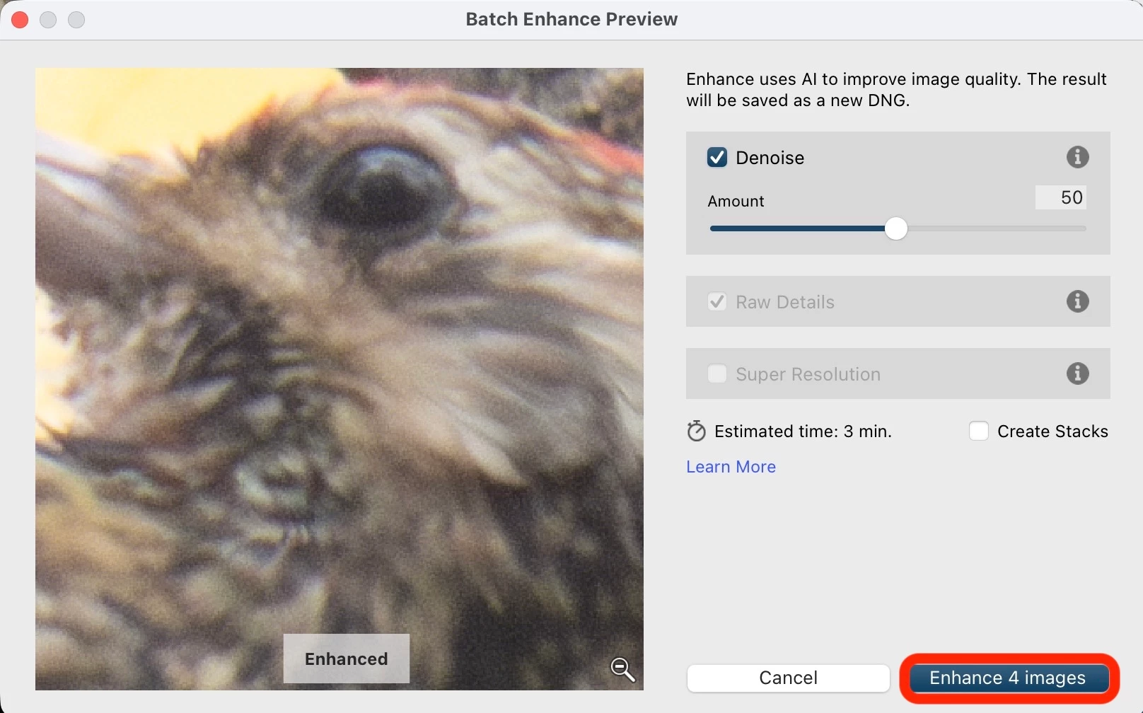

Lightroom Version Number
14.3.1
Operating System
macOS 26 Tahoe
Hello there,
I'm new here so don't know if I'm posting in the right area or even the correct forum...so excuse me if that is so.  This may also be my 2nd post about this subject as there is the new upgrade.
I'm still using LR Classic 14.3.1 because it has "bulk denoise" processing. So i could be "denoising" 40 RAW files or so and step out for coffee PLUS the Removal Tool had 3 choices to pick from. I thought this was the very best improvement Lightroom could have made!!!
To my horror the next upgrade dropped these two things and my work flow was so slow I switched back to vs 14.3.1.
Let me know if Lightroom Classic 14.5 has returned the ability to bulk denoise as seen in the first attachment?
Forever grateful, Riqiv

I'm using 14.5.1.    I selected three images in the Grid View.  With them selected I opened the Develop module and check the Denoise box.   After processing the first image, it then processed the next two.   There are probably other ways to do it.
Traduire
