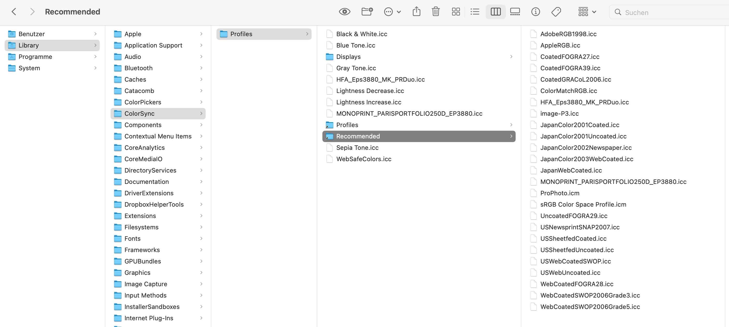

I know this is an old discussion, but the problem is still out there.   I have it and I'm running OS X 14.2.1 (Sonoma) and current versions of light room, and Photoshop as of this date (JAN 2,2024).
I just got off the phone with Epson support, and their recommendation, which worked, was to reinstall my printer. That did the job, but as you know any custom settings for the previous printer were lost when I did that.
The issue is with Epson, and not Adobe or Apple. Epson is now storing their standard Epson paper, ICC profiles in the printer profile folder in the system library, not in the Colorsync profiles folders (system and user).  On my computer that path looks like: Macintosh HD/Library/Printers/EPSON/InkjetPrinter2/ICCProfiles/ .  When I write clicked on one of the .profiles files in that folder and selected "Show Package Contents", I found all my Epson paper profiles.
I asked Epson Support if I was going to have to reinstall the printer every time there was a significant OSX update, and they said "yes".
I don't understand why Epson has taken this approach because it's causing so much grief for all the Epson users, but I did find a possible long-term solution in this blog post: https://blog.conradchavez.com/2020/11/22/printer-profiles-missing-on-macos-a-permanent-solution/
The author recommends locating the profiles folder, creating an alias to it, and then putting that in the Colorync profiles folder. That way the Adobe applications can find the Epson profiles.

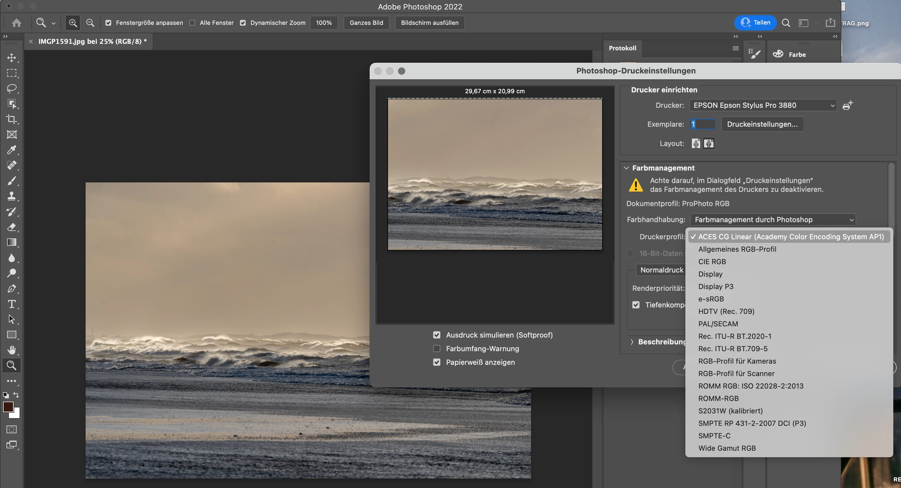

Hi there!
i am using Mac OS 12.2.1 Monterey and i am trying to use my icc profiles, printing with Photoshop 2022.
The profiles don´t show up in the Color Managment.
In the www i didn´t find any answer why the icc profiles in the ColorSync folder are just blank (no color wave image) and no answers yet why the icc profiles don´t show up in the Photoshop drop down menu.
Any idea how to fix this?!
Thanx a lot!

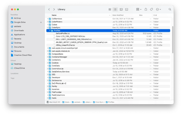

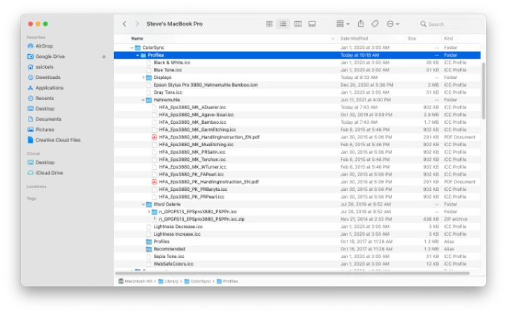

Some -- but not all -- of my printer profiles don't appear in Lightroom's "Choose Profiles" dialog (that I get to either from the Develop module > Softproofing or the Print module > Color Management > Profile > Other). I think this "disappearing" happend when I (rather recently) upgraded my MacOS to Big Sur.
Details:
Here's what I see in the Choose Profiles dialog (and this is the full list that appears; no scrollbar):
There are a whole bunch of ICC profiles that "should" be there, but there are two that I specifically want.
1) ~/Library/ColorSync/Profiles/MUSEO_ARTIST_CARDS_EPSON_3880MK (PPM_Quality).icm
Which you can see here:
My understanding is that any ICC profile in this directory "should" appear in the list.
And 2) /Library/ColorSync/Profiles/Epson Stylus Pro 3880_Hahnemuhle Bamboo.icc, which you can see here:

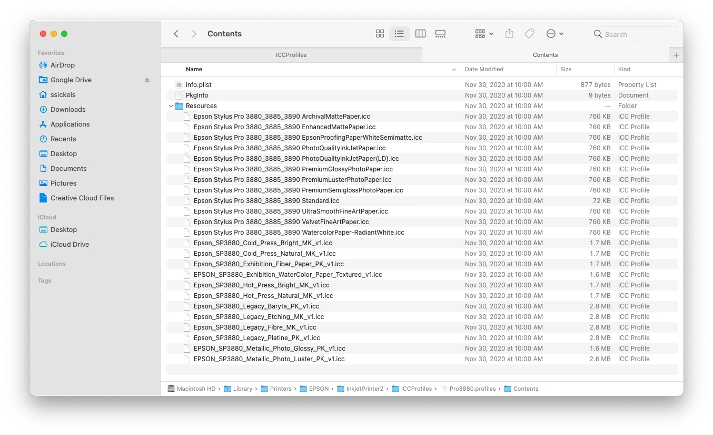

All of the other Hahnemuhle ICC profiles in this directory (and the one Illford profile) do appear in the list. But with one weird exception: /Library/ColorSync/Profiles/HFA_Eps3880_MK_Agave-Sisal.icc (the second Hahnemuhle profile in the list above), which I added more recently than the others.
Also puzzling (although not a particular concern right now) is that of all the Epson profiles here, Library/Printers/EPSON/InkjetPrinter2/ICCProfiles/Pro3880.profiles/Contents, only the four "Legacy" paper profiles appear in the Choose Profiles pick list. You can see these Epson profiles here:
ALL of these profiles have appeared in my Choose Profiles pick list in the past. It seems like it was my upgrade to Big Sur that caused all these profiles to disappear.

It is a bug in that version of OS X and has been discussed here a number of times. You either need to downgrade a version or upgrade to 12.X as 11.6.3 is still buggy.
Author “Color Management for Photographers" & "Photoshop CC Color Management/pluralsight"
February 12, 2022
Thanks, @TheDigitalDog! I've found a bunch of posts where folks didn't know where to put the profiles, but have't seen any mentions of 11.6.3 being buggy.  So, thanks!  I've got some other software that'll likely break if/when I move to 12.X. But, I want my ICC profiles! 🙂 So, I'll bite the bullet...  Many thanks.

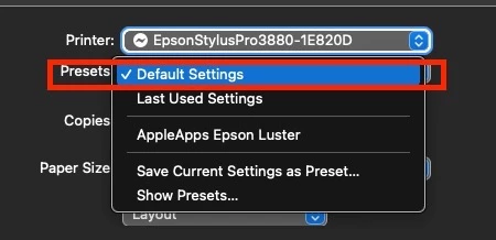

Start from scratch and make a new, virgin Print Template and configure everything in Lightroom Classic's color management AND the Epson print driver (correctly) for Luster. Test again, any different?
NEVER pick an Epson driver preset, always select Default Settings as seen below in LR:
Lastly, if you test this in Photoshop with Luster, is it OK or not?
