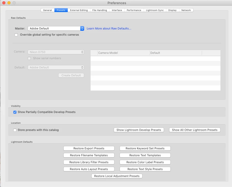

Hello everyone,
I'm having hard time trying to install this presets... I use lightroom from many years but I can not get around this problem. I've tried everything:
-checked and unchecked Show Partially Compatible Develop Presets (final state: checked)
-checked and unchecked Store preset with catalog (final state: unchecked)
-reset prefs
-delete prefs
-reinstall Lightroom Classic from CC
-check visibility on +>manage presets...
-tried to delete the folder of Settings and add then again
Here's the LINK to PRESET maybe you can help me.
Adobe Lightroom Classic v10.2 Camera Raw 13.2
Thanks

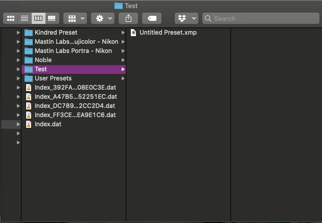

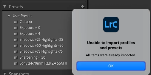

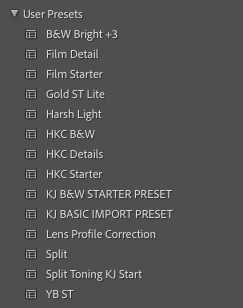

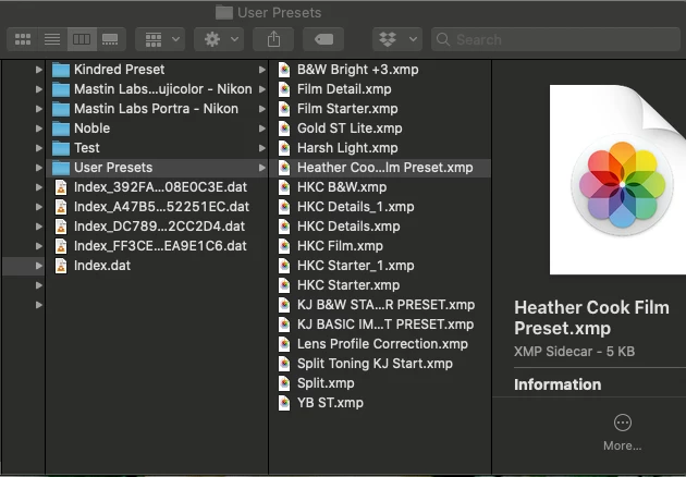

heatherc37673344
Jun 11, 2021 4:28 PM UTC
I work with an editor and she created a preset for me using a non-Adobe profile. She sent it over and I tried to import it. It never showed up in the "Presets" section. So closed LR and opened it again. It wasn't there. I tried importing again and received the error "Unable to import presets. All items were already imported". I checked the user preset folder and it is located there. I tried multiple ways of importing, including renaming the preset, and I received the same error every time.
So I tried creating a new folder and importing the preset there. The folder does not appear either (even after restarting LR). Then I tried just saving the current settings of the preset to an older preset. That preset disappeared IMMEDIATELY. Then, I was reading around some more and saw someone posting about issues with non-adobe profiles. So I tried creating a new preset with the profile set to Adobe Standard and the preset showed up immediately in the Presets section.
It seems there is an issue with creating presets containing non-Adobe color profiles. I have checked all the settings I can (see attached screenshots). Has anyone encountered this before?
johnrellis
Jun 12, 2021 7:41 AM UTC
When you import a preset that refers to a camera or creative profile that's not currently imported into your LR, then LR will import the preset but it won't warn you about the missing profile and it won't display the preset in the Presets panel.  See this bug report:
https://feedback.photoshop.com/conversations/lightroom-classic/lightroom-classic-presets-silently-omitted-when-they-refer-to-nonexistent-creative-profiles/609d5f6ee077c600a4628cfd
Please add your constructive opinion to the bug report and be sure to click Like and Follow at the bottom of the first post. That will make it a little more likely Adobe will prioritize the fix, and you'll be notified when the bug's status changes. Product developers rarely participate in this forum and won't see your feedback.
Ask your editor to send you the camera profile (a .dcp file) or the creative profile (.xmp file) that the preset references, and then do File > Import Develop Profiles And Presets to import that profile.  That should cause the preset to appear in the Presets panel.
