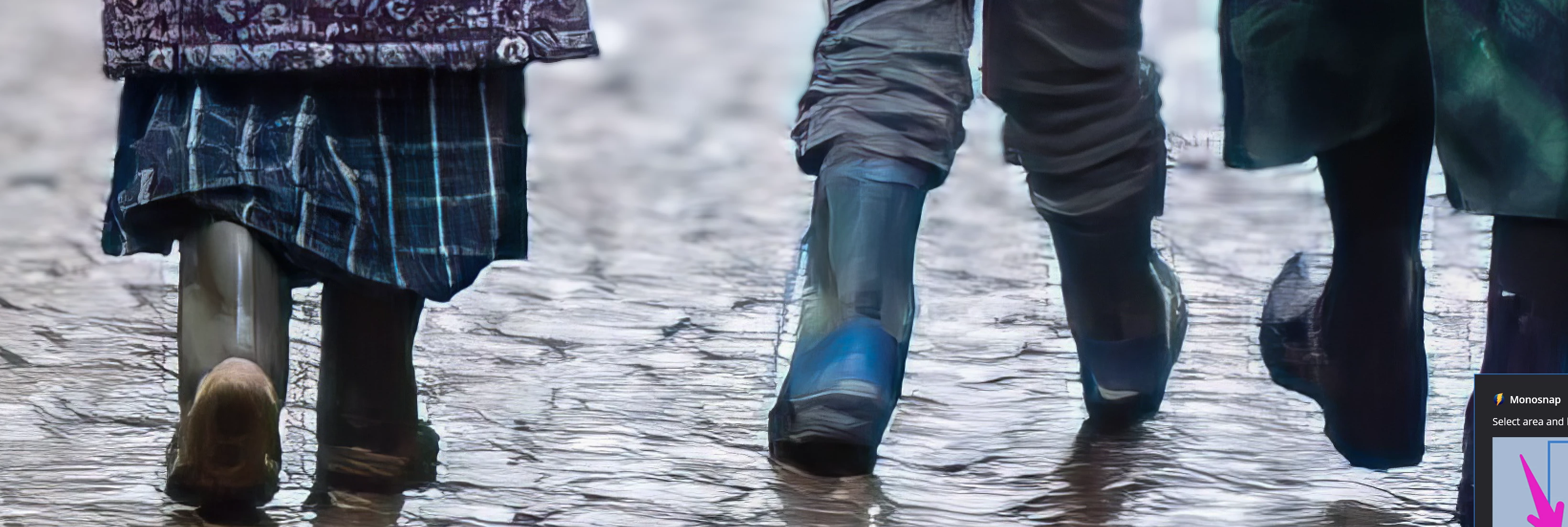

Viewing Anthony Mroganti site.
fond the blur function very easy.  It correctly identified the subject with no additional adjustment.  Upon enlagring the photo to check the total image I found a strange aboration around certain parts of the subject. Note captured area.
Adobe Employee
Oct 16, 2023 6:29 PM UTC
The Refine tool is available to do some clean up in the missed area.
