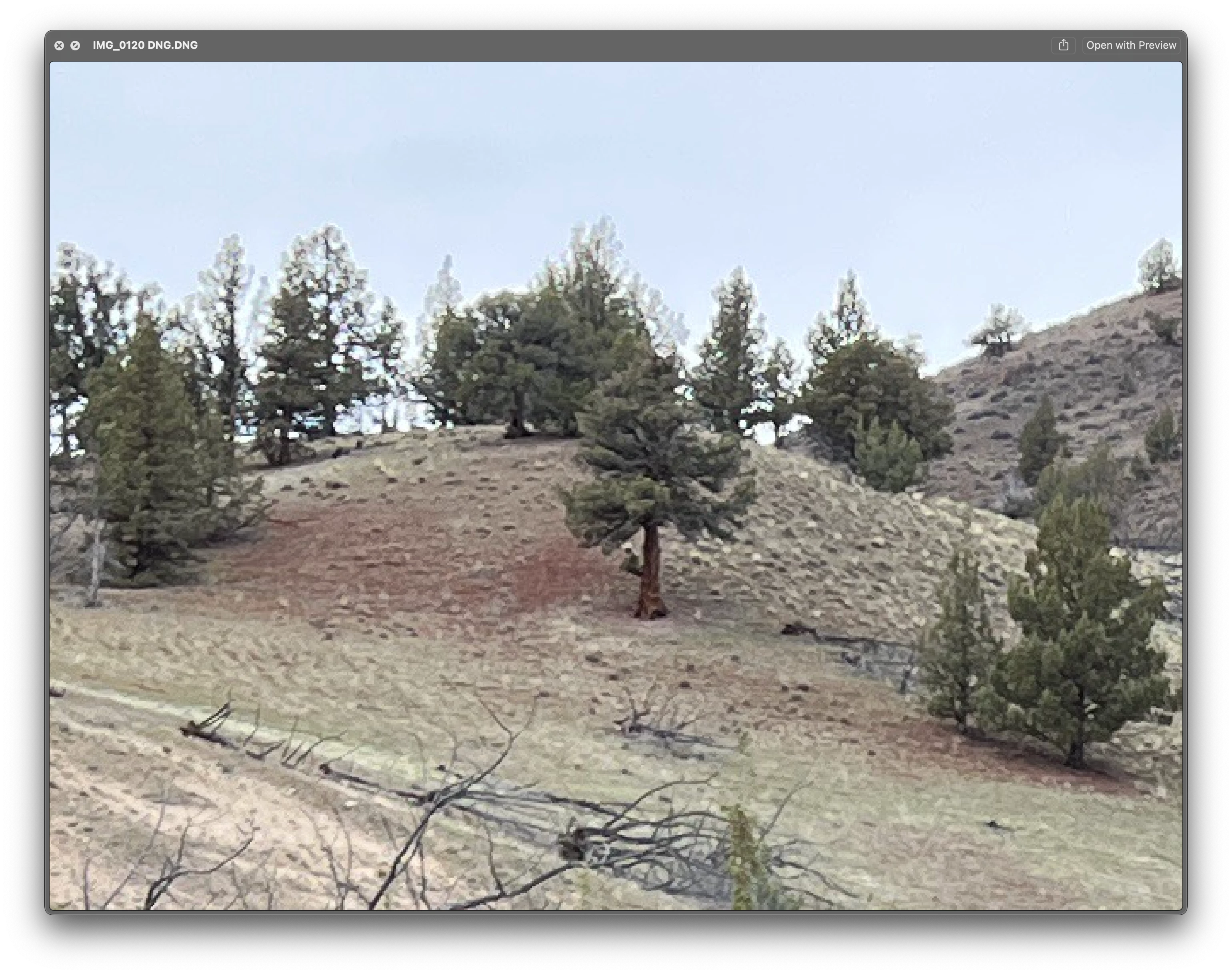

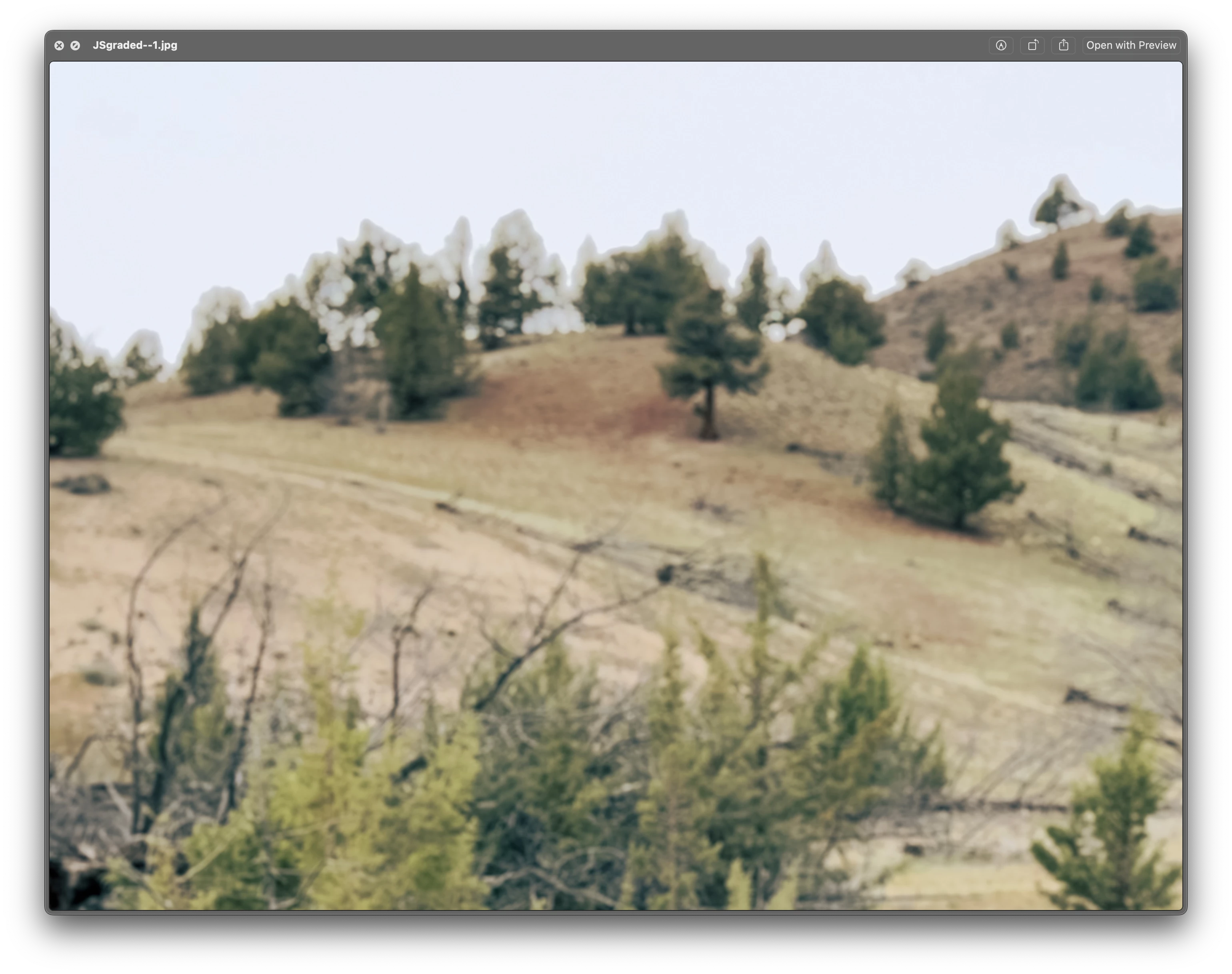

Also, I have this one photo (taken on iPhone) and the blur was doing some weird things on the edges of this hill. The non-blurred picture is a screenshot of the RAW photo (taken in DNG raw) and the other screenshot was an exported JPG with edits including blur.
