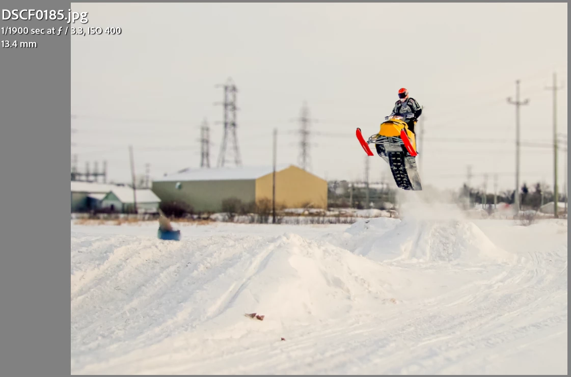

Enjoying this new feature as relates to portraits etc.  To me,  it is most useful for photos taken with equipment that did not allow for natural DOF in the first place. I enjoy going over OLD photos and attempting to make them look like they were taken with lenses that produced shallower DOF. So, that takes me to images like this, taken in 2009 with my Fuji s100fs bridge cam. The background is obviously really cluttered so I've cropped in about 50 percent, then I ran the filter:
Here's before:
After applying the filter and adjusting it to 100% so I could see the full effect then back down, I actually couldn't see ANY effect at all. Then I tried experimenting with the focal range selection and that worked amazingly well. I had to use the selection brush to blur parts of the power pole right behine the rider, but that worked very well too:
I took me a bit to get the hang of post application adjustments but to me this is really a great filter. I did want to go further and brush in a few adjustments but found the "Blur" brush was actually UNDOING the effect that was already there. I'm really puzzled about that and would appreciate advice on it.
The sensor on that s100fs was only 2/3 of an inch so DOF wasn't something to write home about. I shot a lot of sports with it and sold framed prints from images cropped to 1/8th or less their original size then painstakenly step by step enlarged in PS, then selected the subject onto its own layer then removed the subject from a copy of the original layer, then blurred that layer and applied a mask with a gradient filter to it for a somewhat realistic result.
Golly Gosh Gee Whizz ...this only saves about AN HOUR OR TWO OF WORK PER IMAGE to get similar results.
GREAT WORK ADOBE!!
Sure would appreciate advice on using the Blur brush so as to avoid it overriding what the initial filtering did.
Adobe Employee
Nov 5, 2023 11:16 PM UTC
Checkout Julieanne's nice tutorial video. And check out this post
