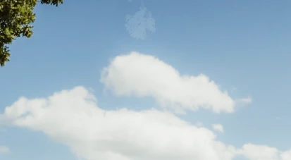

P: Perform Healing Operations ( CAR / Spot / Clone ) before AI Selection (Sky, etc) for best results
Problem: When I use the spot removal tool in Lightroom Classic version 11 to remove a leaf against open sky after Sky Select was used, Lightroom fails to remove the spot completely. It leaves a light gray version of the leaf behind. See samples below. I checked and opacity is set to 100%.
The problem does not occur if I do spot removal before Sky Select is used.
This is on Windows 10, working on a Fuji GFX 50R RAF.

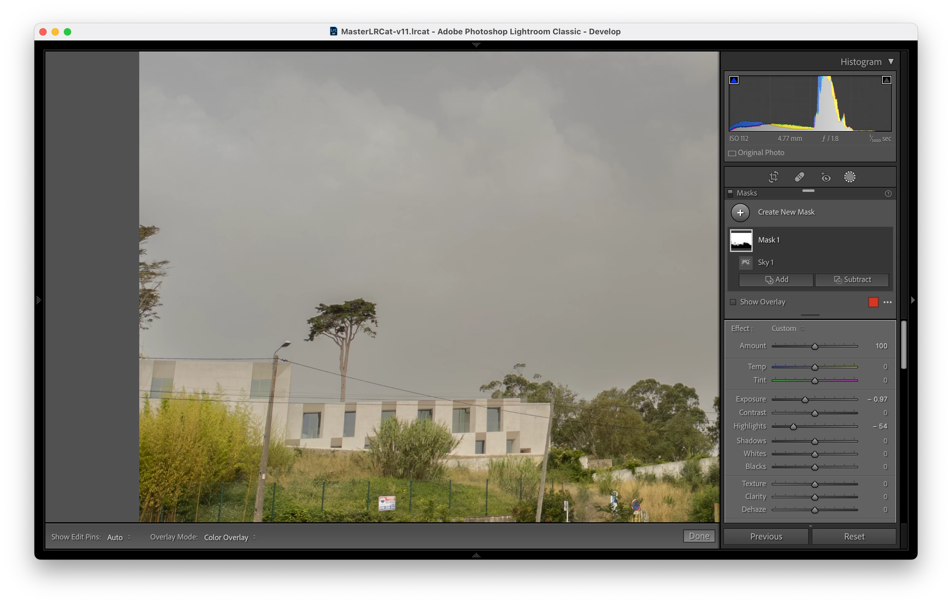

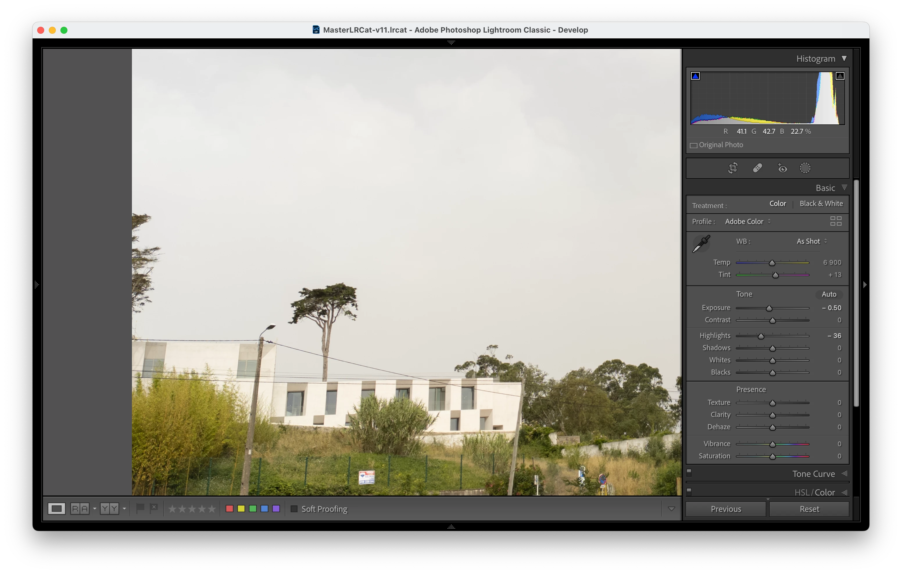

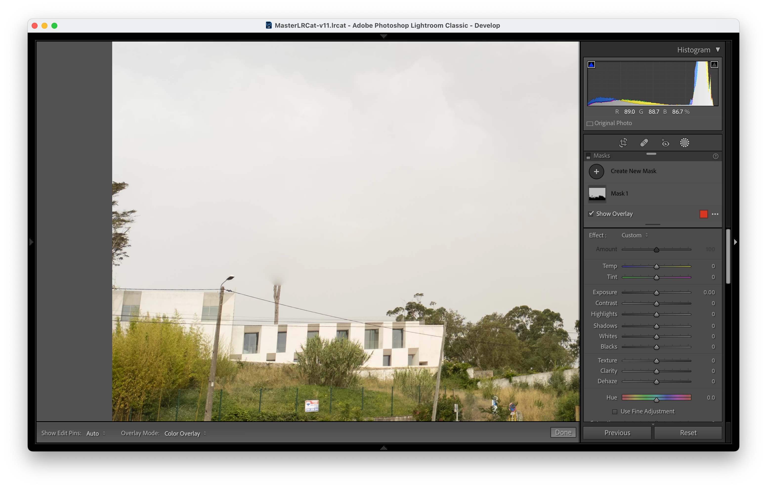

June 15, 2022
Lightroom Classic v. 11.4
MacOS 12.4 (Apple Silicon)
1. Select the sky using the "Select Sky" mask option
2. Adjust any of the possible parameters making the selected sky significantly different (darker)
3. Using the Spot Removal tool, erase some sensor dust or any object inside the region affected by the sky mask. (using Heal or Clone options make no difference)
What happens:
The object is erased but leaves a bright contour that does not reflect the adjustment applied to the sky mask.
More information:
Reversing the order of the tools, (Spot Removal first followed by Select Sky mask) gives the expected correct result. The problem seems to only appear with Select Sky mask, all the other mask options work fine (did not try Select Subject)

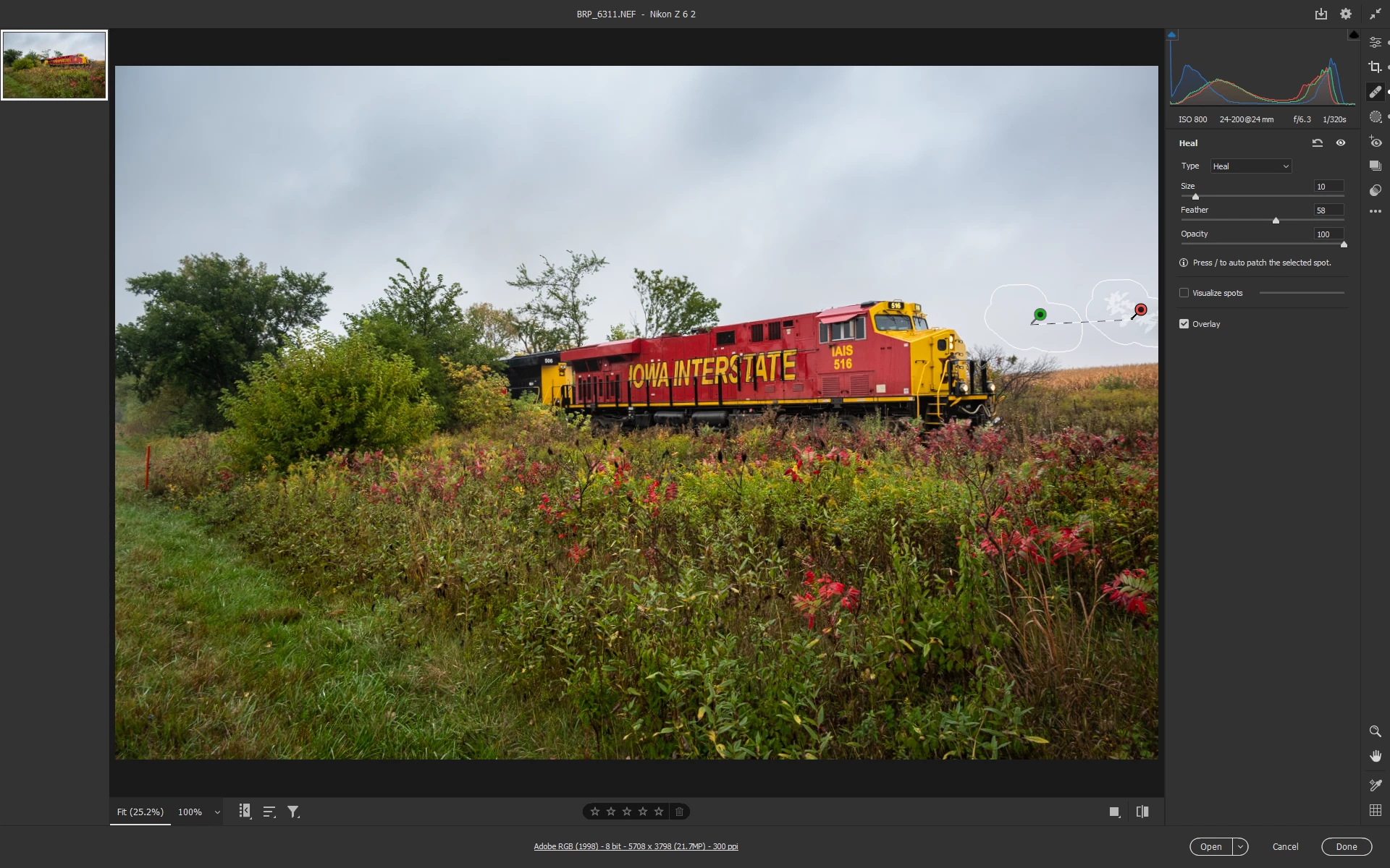

November 19, 2021
Upon updating to Camera Raw 14 and testing out the new masking functionality, I've found a major flaw. It seems that Camera Raw's Healing Brush is sampling data from the image "under" the adjustment masks/layers. See photo:
The tree branch is cloned out; however, the replacement data is far too bright, as if it is sampled from the unedited, original state of the raw file
Benjamin Root
Edit: Oops, I had only searched the Camera Raw forum and failed to search the Lightroom forum as well. Thanks.
