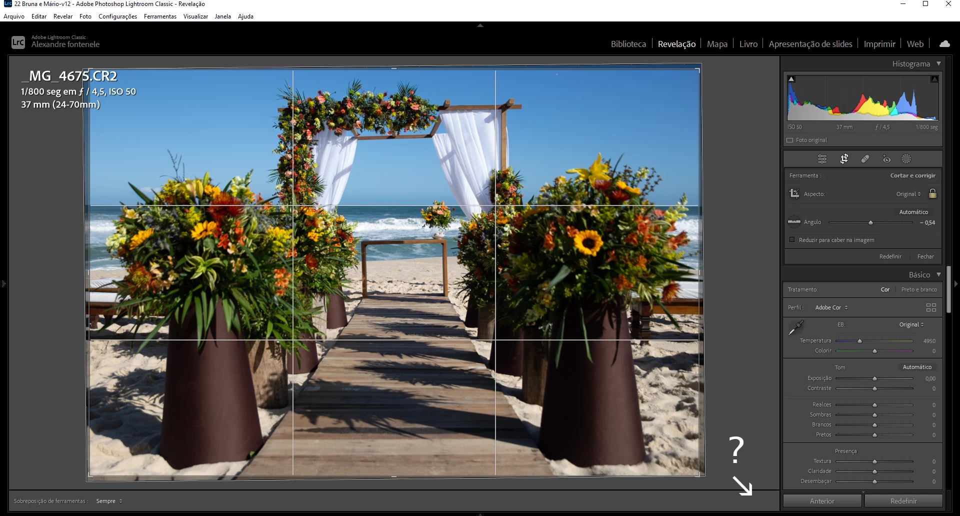

Nov 7, 2022 12:21 AM UTC
Olá. O botão OK sumiu na barra quando uso a ferramenta cortar. Quando aperto o T a barra reaparece, mas sem o OK. Como resolver?
George_F
Nov 7, 2022 1:12 AM UTC
Adobe has done away with the "Done" button in most of Lightroom in the most recent updates.  Instead, the Editing Panel has its own button now.  You just click on that button to get back to the editing panel.  It does take some getting used to, but I've found I like the update pretty well.

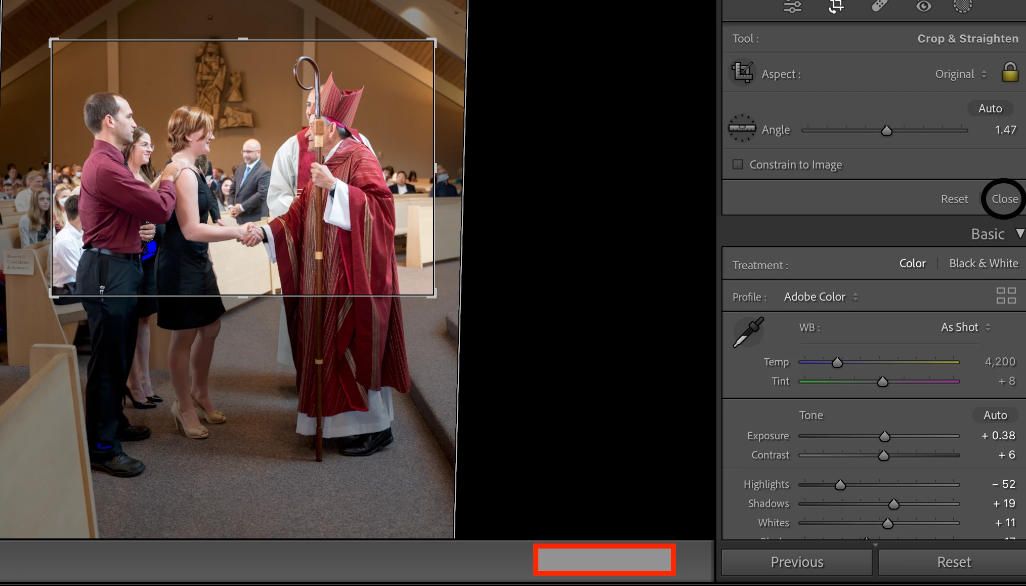

Nov 2, 2022 4:28 PM UTC
After my update to LRC 23 in my masking tool and crop tool, I can't see the checkmark to accept the results. I have to go to the actual tool and select close. That doesn't seem like it use to be. Any advice?
MacOS Monterrey
LRC 12.0.1

Oct 30, 2022 2:00 PM UTC
Just updated to v12 and working with cropping tool.  Where did the button go to close on the bottom ribbon?  Now in order to close, I need to use the side right bar.  This is not as convenient.  Any chance the button is coming back?

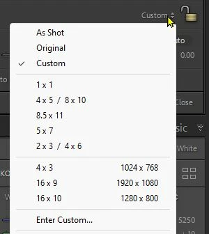

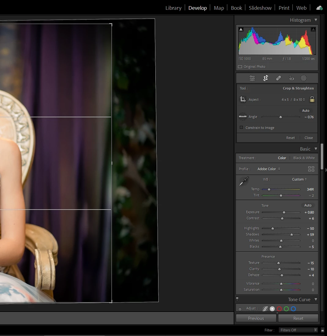

I've just upgraded to 12.0 for Lightroom Classic on Windows 10 on PC (didn't really seem to have a choice about that) and now the crop tool is no longer working like it used to and I don't know how to get it back.
If I go to crop, the Done button has disappeared, but worse than that, I can no longer manage the grop from one side or one corner. It now just automatically crops the whole lot keeping it in the same ratio the photo was taken.
I've searched in Preferences but can't find anything that will put the crop tool back to where it was. Does anyone know how please?
Rob_Cullen
Oct 26, 2022 5:40 AM UTC
The [Done] button has been removed in v12- It is redundant! (FOUR other ways to [Done].!!}
1) Click the (new) Edit Button instead, to return to Developing-
2) Or- Click on the Crop Tool icon once again,
3) Or press the [Enter/Return] key.
4) Or Press keyboard key [R]  which both opens and closes the Crop tool.
To enable changing the "Ratio"- click on the Padlock to 'open' it allowing a 'Freehand' crop.
Click on the context menu next to the padlock for crop ratio presets.
Use Custom ratios, that you define, and LrC will store up to Five of your custom ratios.
Regards. My System: Windows-11, Lightroom-Classic 15.6, Photoshop 27.8, ACR 18.7, Lightroom 9.4, Lr-iOS 10.4.0, Bridge 16.0.3 .
Oct 26, 2022 5:47 AM UTC
Thank you, Rob, appreciated. So I understand about the Done button. But with crop it means I still have to stick to a ratio, even if it's one I preset? I can't just freehand crop anymore?  I find that quite disappointing. Do you know why that decision was made? I found the freehand cropping so useful and used it constantly.
