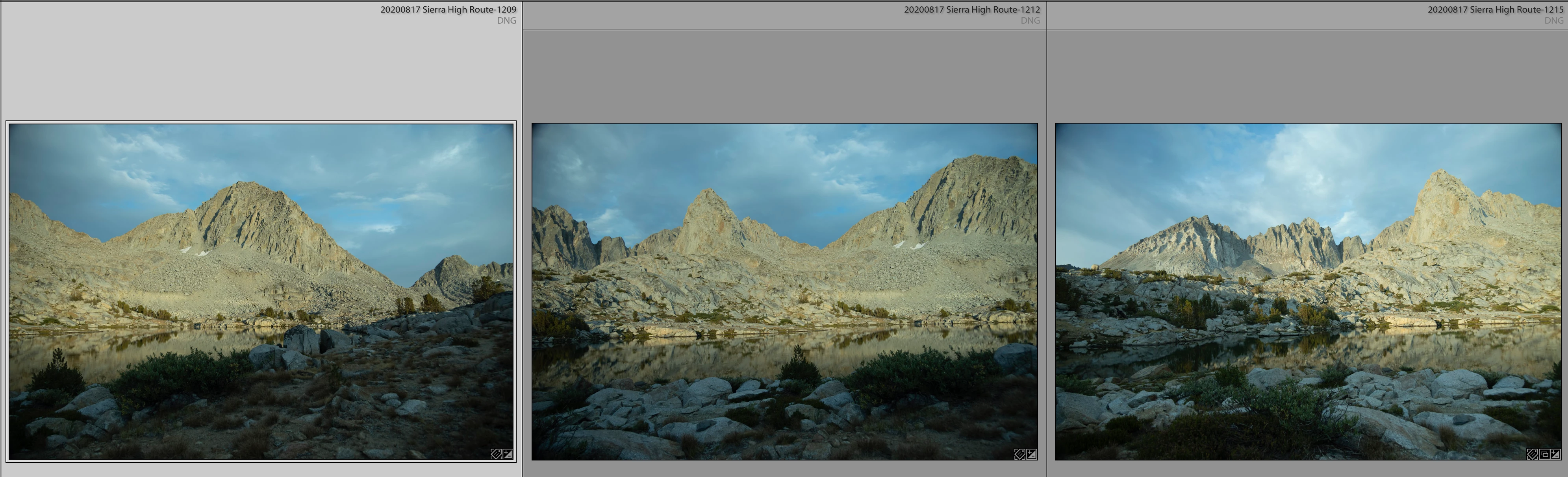

Over the last few weeks I have had inconsistent merge results creating panoramas. Maybe one in 10 has a fail. Here is an example (very repeatable):
Input images:

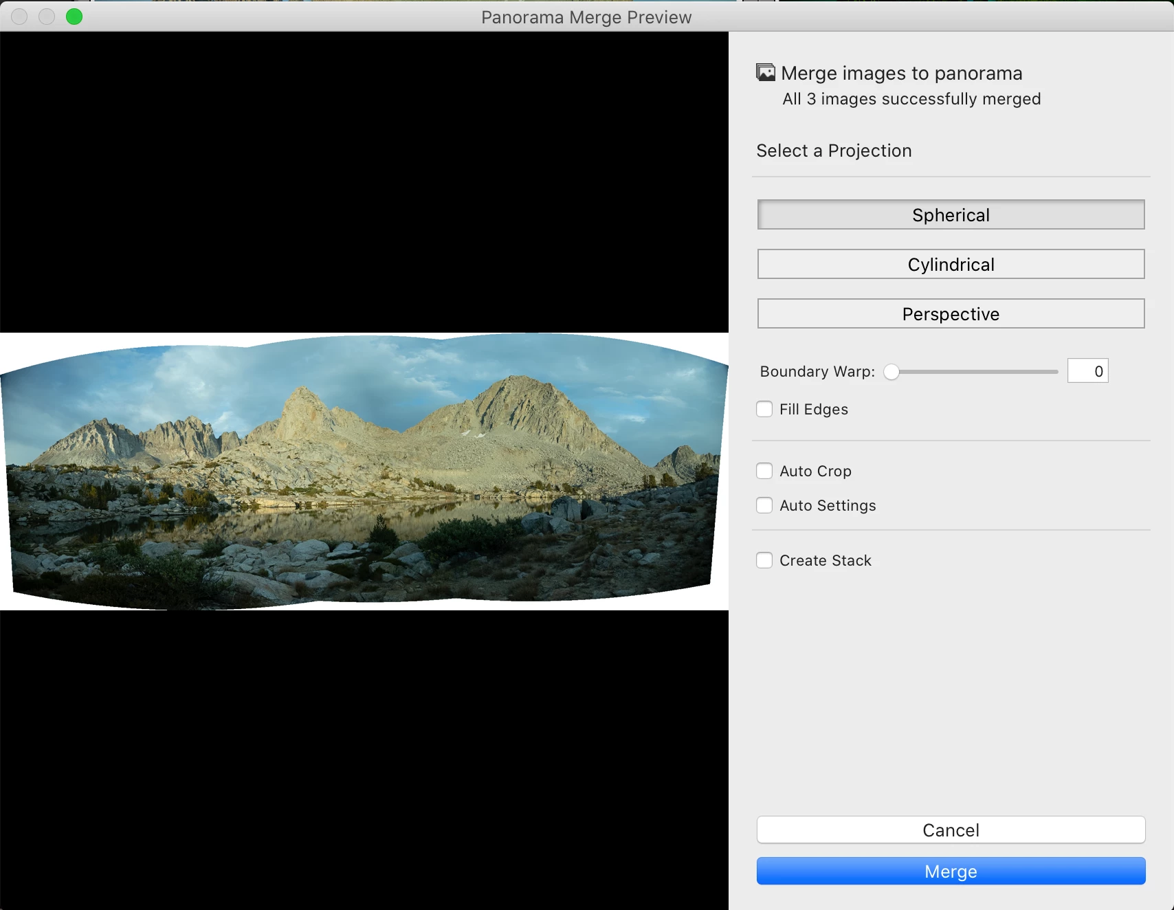

Then I go to the pano preview (this was set to spherical, but it fails the same in cylindrical):
It looks good! No color banding!

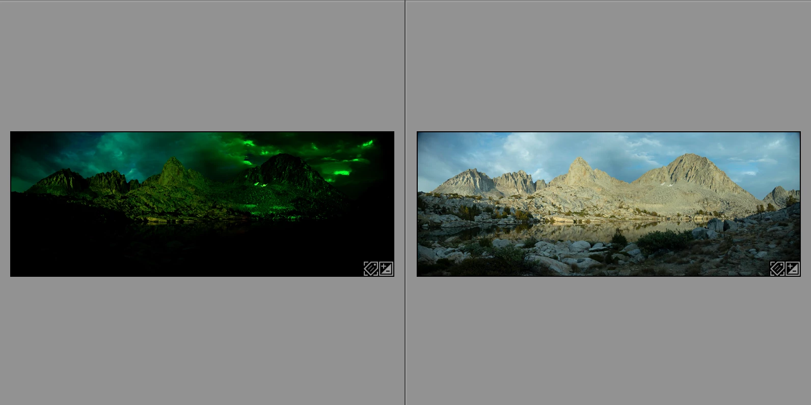

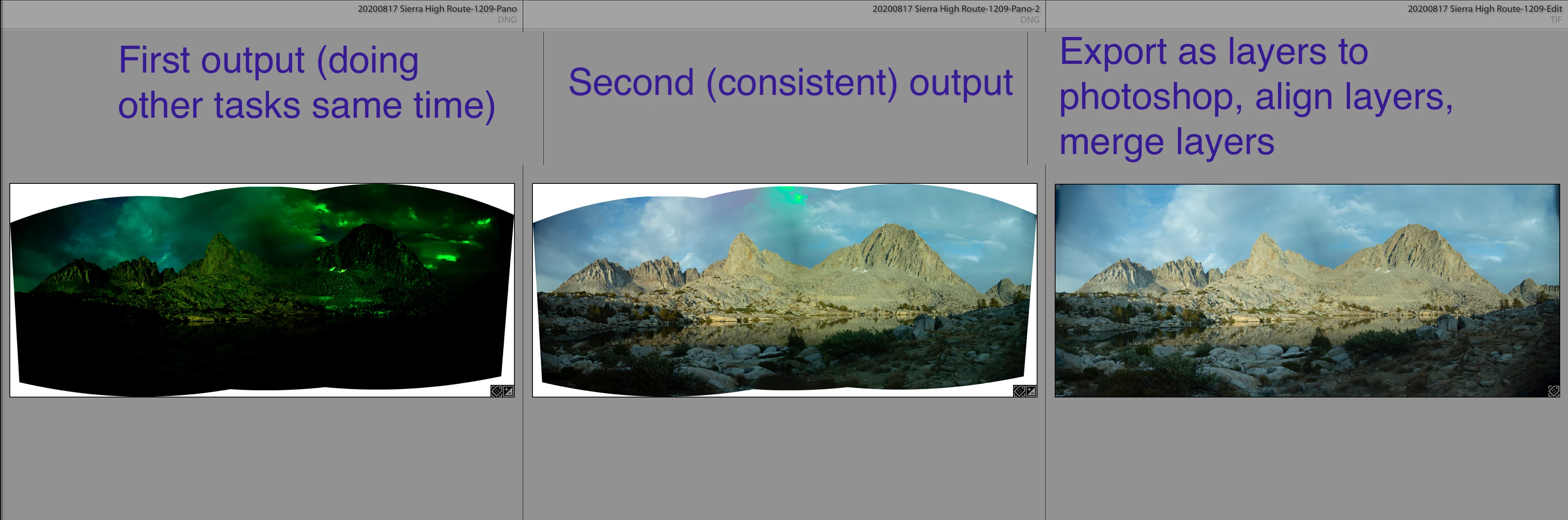

And the results is inconsistent (and compare to the result when I export as layers to Photoshop and merge):
I have noticed that images with problems seem to have more fails when I'm doing other tasks at the same time while the pano processing is going on. Sometimes I can create a new pano without any problem a second time.

3. All photos were the same exposure?
Strike that, unless way different, should still work, I have intentanaly opened up in foreground on multi row Panos with no issues.

1 Please verify that before you Merge Pano, that you did absolutely no mods to the originals. (any Adobe default sharpening, not important to this)
LrC will ignore most of that during the merge, so typically just wasted extra effort. However...
mind you, that should be an old occasional glitch. Post v9.3 with the new RAW Develop settings, that is hopefully not the issue.
August 26, 2020
The only import correction I use is for Remove Chromatic Aberration and Enable Profile Correction (I use a Canon Lens that REALLY needs the profile correction at wide angle). That being said, I turned them off and the merge seemed to work fine... Great catch. I'll keep trying on future fails, but a great start. Thank you!
