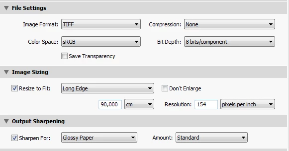

    To print an image 900 mm x 600 mm @300 ppi, you will need 10630 x 7087 pixels.
    This is because 900 mm equals 35.43 inches (900:25.4), and 35.43 x 300 = 10630.
    The image from your camera is 5472 x 3648 pixels (20 megapixels), and the image you want to print needs to be 75 megapixels. (at 300 ppi)
    But if this is inkjet printing, you don't need 300 ppi for such a large print, I use 180 ppi for large prints on my Epson printer.
    The number of pixels in your image allows printing at 154 ppi without enlarging (900:25.4 x 154.432 = 5472), and I would make a test print to see if it's good enough.
    Your export settings should be something like this:
    The image format is set to Tiff here, but I believe most printing services want Jpg files, in which case you should use 100 quality.
    Which printing service are you using? Do they want files in pdf format?
    As for the 1140 mm wide prints, they will only be printed at 122 ppi without enlarging, which may, or may not be good enough.
    And note that all the calculations I'v done here are based on an uncropped original from the camera - i.e. it is 5472 pixels on the long side.
