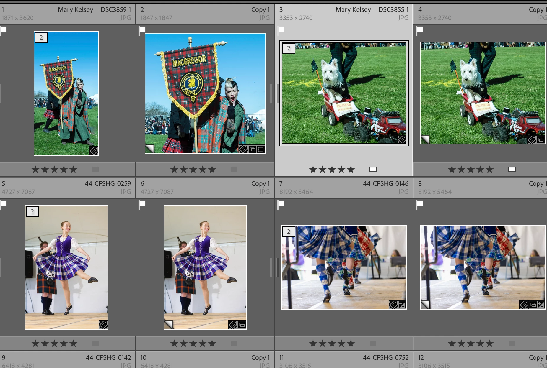

I just opened Library after updating to 14.0.1 and images appear as duplicates 1of2 and 2of2. The "2" is the "developed" (virtual) image. When I choose "show image in finder" both images link to the same original.
Why has this happened?
How do I fix it?
Going throught thousands of images and deleting the virtual copies and re-doing the deveop settings is simply not going to happen.
System: 2021 Macbook Pro, OS 14.5

Correct answer Alienduck
All four of those copy's in that screenshot are virtual, notice the bottom right corner of the thumbnail.
So, you do not remember making those virtual copy's? A difference between LrC creating an outright copy and creating or the user creating a virtual copy.
One suspicion, an accidental batch creation of virtual copy's.
Now, I am not at a computer to test, but to work thru what victuals are unwanted, perhaps filter on virtual, label those, then filter thru the labeled for no edits.
I found the issue, and it was likely user error, though for the life of me I cannot figure out when/how. I found a collection if nearly every photo in the library. However, in only contained the vitural copies. I deleted a couple to see if I'd lose my develop settings, and all was good. I've deleted the copies and the collection. -- All seems good. Just goes to show that even years into using sofware, unusual mistakes can still be made.

Mostly correct. There are some virtual copies that I made in months/years past (cropped differently etc.). Those I'd like to keep. However, now every photo has a "copy-1" next to it. In the attached you can see the first image is one that was intended. The others are not. All in stacks. Some images have developed differences, some have no changes at all, but a copy "appeared" nonetheless. -- This is most unusual, and I was hoping for a solution, before resulting to a backup, which seem inevitable.
GoldingD
October 31, 2024

Thank you for the reply, but this does not remedy the issue. The problem is that my develped settings would be lost. Months of labor, if not more, would be lost. -- And still begs the question, why did this happen to begin with?

AD, I'm confused so I went back to your original post.
" images appear as duplicates 1of2 and 2of2."
The "2" is the "developed" (virtual) image." <-- Original (Master) and virtual copies can be developed. Developed and Virtual are not synonyms.
Prior to using Photo>Create Virtual Copy, Copy 1 and Copy 2 do not exist. Creating a virtual copy creates a new catalog entry but does not create a new file.
The original file and the virtual copy share the exact same name; same extension.
In Loupe view, the original file displays as filename.ext and the virtual copy as filename.ext • Copy 1.
The original file will never appear in the Loupe view as filename.ext • Copy anything.
In Grid view, the upper-left corner displays the number of catalog entries (original and duplicates).
In Grid view, hovering the cursor over the original changes the number of catalog entries to display the total number of copies, i.e., "1 of 2" and the filename.ext.
The virtual copy will display "2 of 2" and filename.ext • Copy 1
Of course all virtual copies point to the original file in the folder.As MacLeod said, There Can Be Only One.
Deleting copies retains the original file but yes, their copy edits are lost.
As far as deleting entries, deleting a copy will get a warning from LrC:
Remove the selected copy? with the choices, Remove from Lightroom and Cancel
Deleting the original will get this warning:
Remove Photo from Lightroom Catalog
This photo will be removed from your Lightroom Catalog and any synced Lightroom Clients. Select "Delete from Disk" to also move the selected photos on your computer to the Finder's trash.
One virtual copy will also be removed.
with the choices, Remove from Lightroom, Delete from Disk and Cancel.
The copies take up next-to-nothing storage space, only increase the catalog size negligibly.
