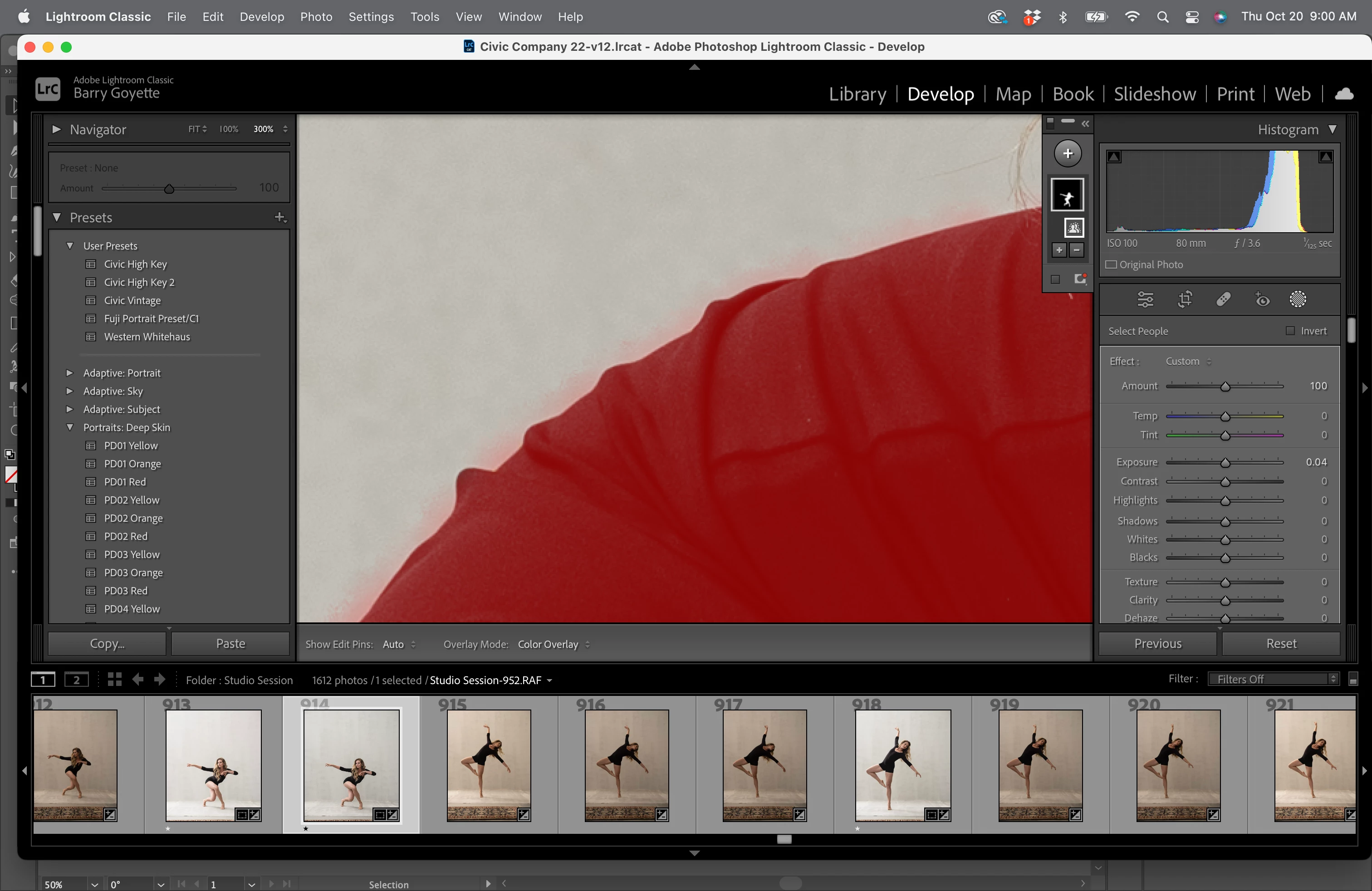

I'm wishing I didn't update right now. The select subject mask appears to have taken about 3 steps backwards in accuracy. It's still haveing trouble with blonde hair on light backgrounds, but now is adding a significant feather to sharply defined black shapes against the same light background. The hope here was that this feature would improve in its accuracy, but we just got a bunch of new functionality while the accuracy seems to have gone in the absolute wrong reaction. I don't know a use for this tool in this program any more.

Really trying to teach myself the AI masking in LR, but garsh they've made it difficult. This new update adds all this AI magic, but unfortunately has gone backwards on both accuracy and intuitivity.  Today's mess comes when trying to edit a Select people mask. The AI maks produces a mask with errors. If I go in with the brush tool to correct things (subtracting from the mask with the brush)...I end up with this weird combined mask that doesn't ever function like a single mask. I can't invert it without it switching to the "edit" mask, and the invert button dissapears when you select what should be the "combined mask".  I've been using these products since Photoshop 1.0 and I honestly don't know if the simple edit I'm trying to do to an AI mask is possible in LR, or if the tool is just so counterintuitive as to have been designed on another planet. Can anyone help?

October 24, 2022
