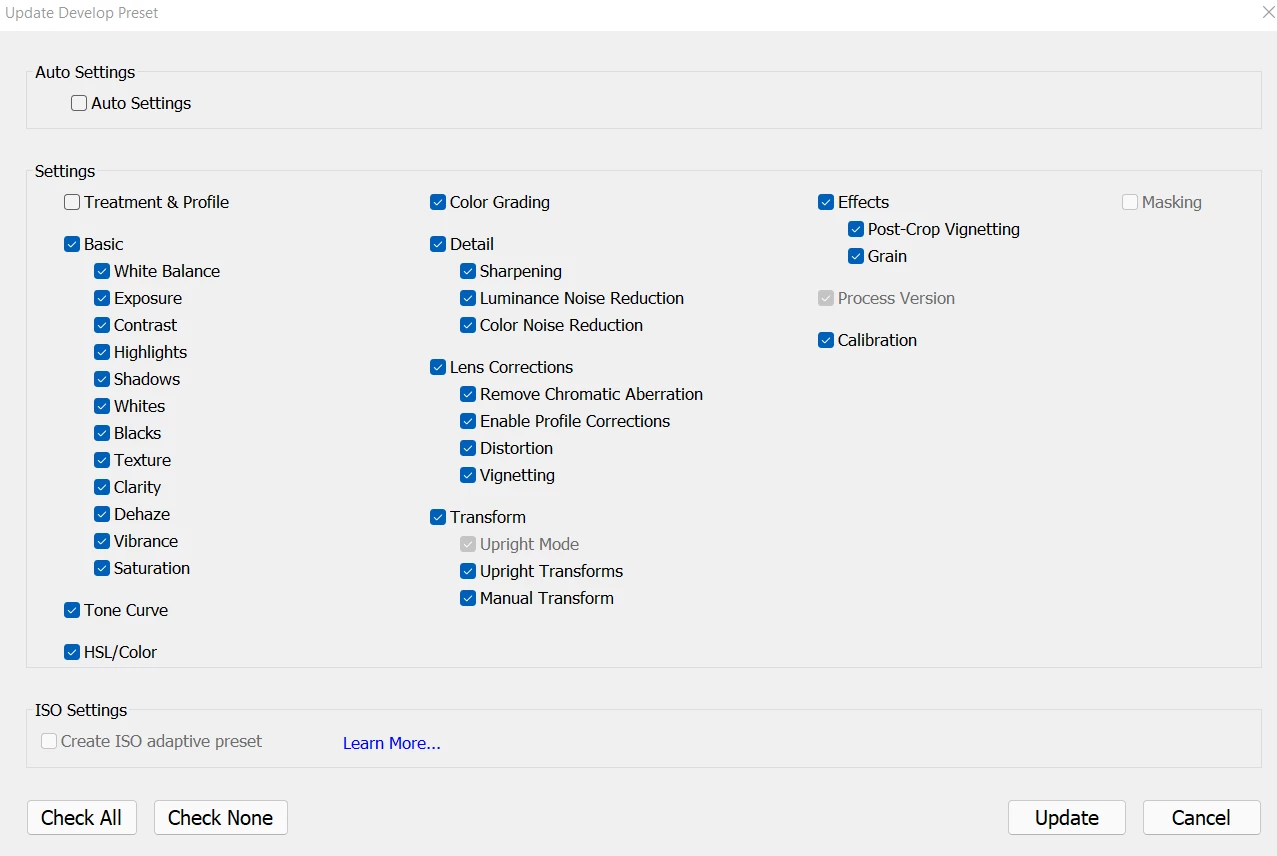

I can find a lot of posts about how masks get passed in presets, but I have a preset that completely resets an image to zero - everything.  It leaves the white balance as shot, and everthing else is zero.  And I can apply it to a group of images I want to use repeatedly for demonstrations to ensure they start clean.
My problem is I can't see how to have it also remove any masks on the images.
I deleted all the xmp files, but that didn't work.
I tried putting an empty mask on a image, that didn't work.  The "update preset with settings" doesn't let me select Masking.  I CAN put a mask on that actually DOES something, but thats the OPPOSITE of what I want.
So, HOW do I keep a set of images in Lightroom, and completely clear EVERYTHING including any masks on them with a preset?

All adjustments except masks. Adobe had the same problem with this preset as anybody else: you cannot select masks when you create a preset if the active image does not have any masks.

There doesn't seem to be any way to do this with a preset, with how presets / syncing are designed.

This was changed with the new masking. A preset will always merge masks, not replace a mask. That means you cannot delete all masks using a preset that contains an 'empty' mask, and you cannot select 'no mask' either.
