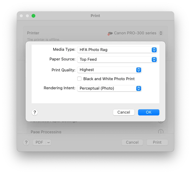

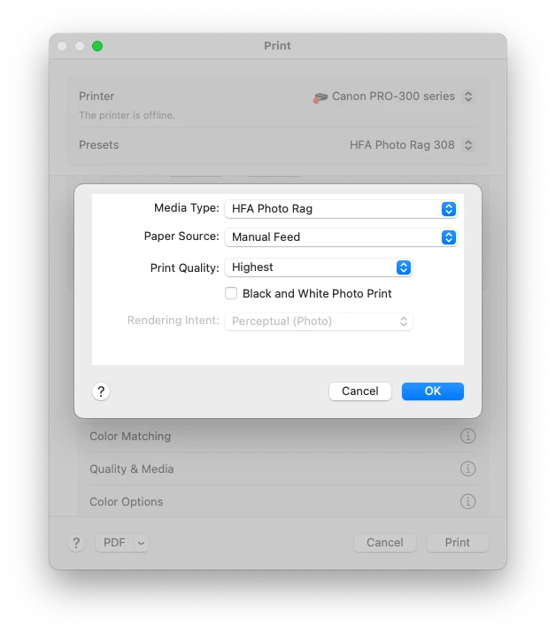

Here is an example. The screenshot on the left is from Photoshop and correctly shows what is in my printer preset. The screenshot on the right is what was loaded by LRC. Note that the paper source was changed from Manual Feed to Top Feed. When I tried to print with paper the manual feed tray, the printer complained that the top feed tray was empty, so I know this not just a case of incorrect data display.
This problem is intermittent, sometimes it works, but more often than not media type, paper source or color matching are changed.
