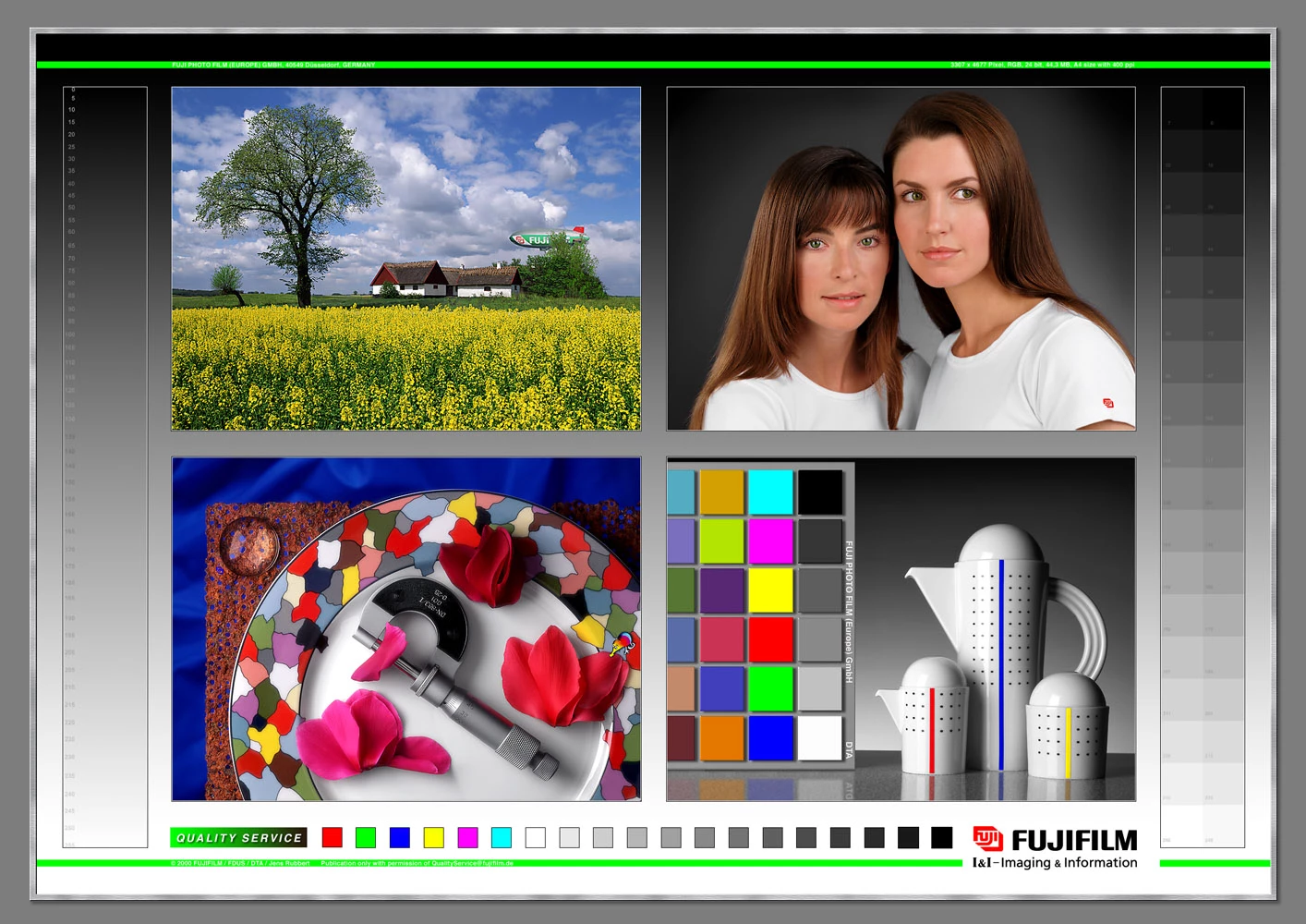

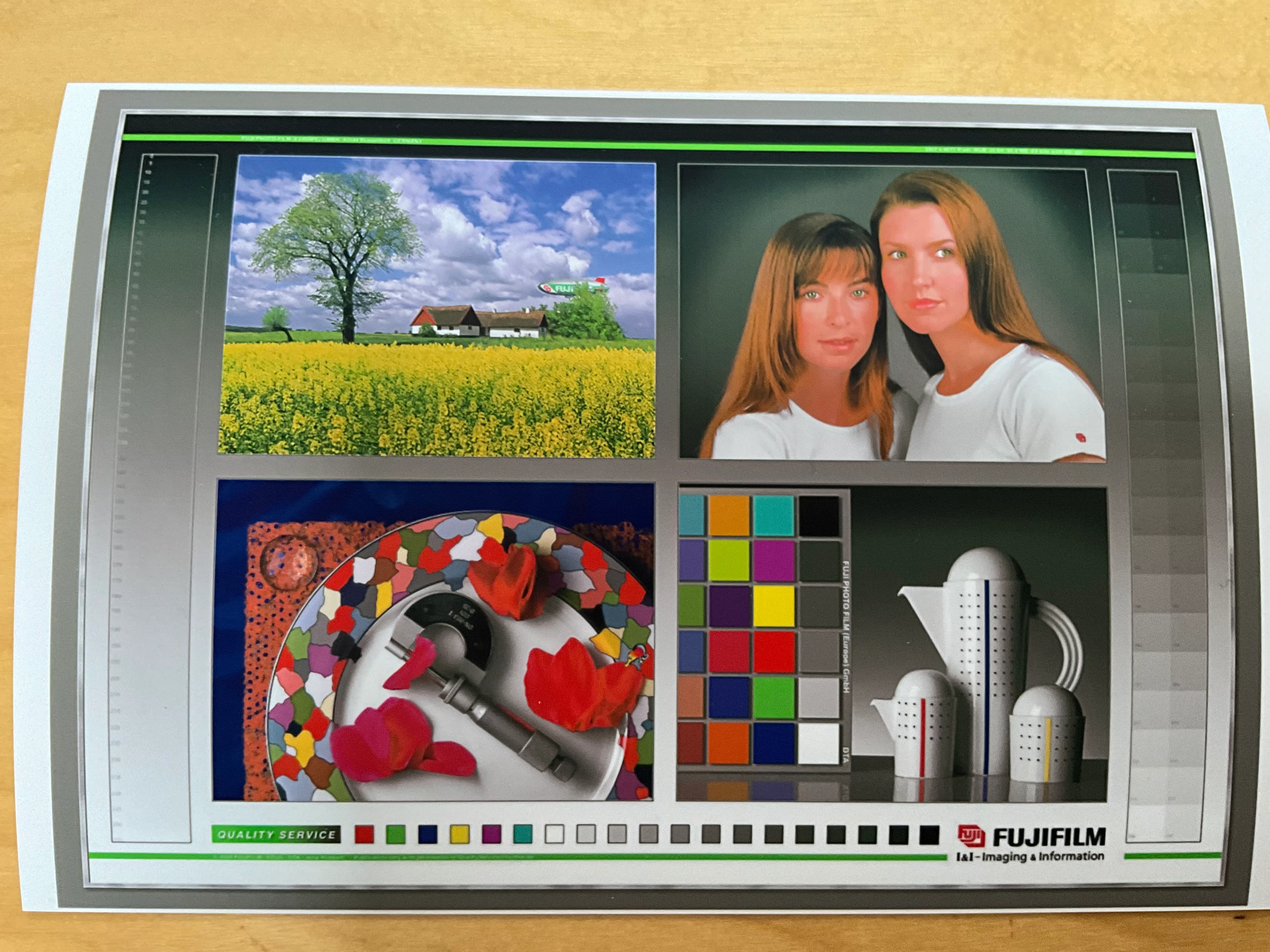

I have attached a standard Fuji test image and a snapshot of the best test print of it I could produce (you will have to trust that the shot reflects the actual printed colours).

This issues sounds more related to Sonoma than Canon or Lightroom. Rolling back is painful but if printing is your number one priority Sonoma is likely the culprit. In working with clients having new issues with their longstanding print workflow the common denominator is Sonoma.
