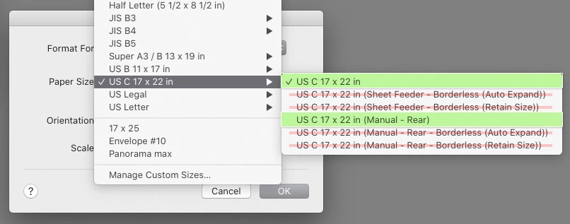

  1. The correct printer must be selected in Page Setup (Lightroom Classic) or Print Settings (Photoshop). When this is not done, the selected Printer will say Any Printer instead of Epson P800. If it says Any Printer, generic margins will be used and they will be wrong, and probably unequal (not centered). Selecting Epson P800 will retrieve that printer’s exact printable area from the P800 printer driver, and that will set the margins. By the way, this is not an Adobe dialog box, it’s an OS dialog box filled by the Epson printer driver software.
  2. Select a paper size that does not say Borderless. If a paper size says Borderless, the way the printer ensures no white area at the edge is to scale up the image so that it extends past the paper edge. Of course, scaling means it is no longer the size that was specified in Lightroom Classic or Photoshop. Choosing Borderless is a common cause of unintentionally scaled print sizes.
  3. Of course, make sure Scale says 100%, but you probably already checked that.

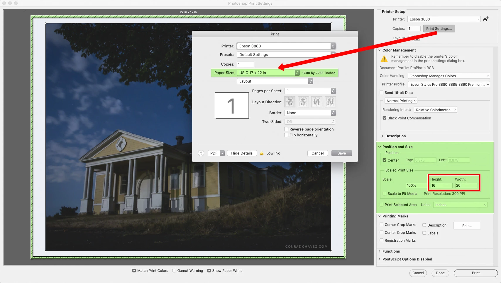

That should not be happening. The Print dialog box in Photoshop should show you a detailed print preview window, shown below, right down to the margins. There, click Print Settings to make sure the correct Printer and non-borderless Paper Size is selected. Again, that is in the Epson printer driver software.
When you click OK, you are back in the Photoshop print preview dialog box. There, check Position and Size to make sure they are as expected. The preview on the left shows you the Position and Size within the selected Paper Size, and you can see the printer-specific margins around the edge marked by the zone with diagonal lines. Again, those margins depend on the printer driver settings you selected, mostly Paper Size. This print preview is provided so you can visually anticipate and correct for any mistakes, before you waste paper and ink.
