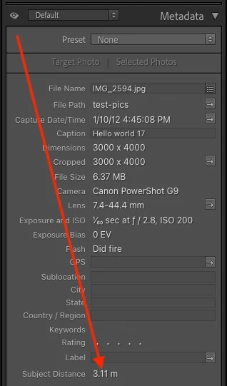

February 10, 2022
Subject Distance was removed from the Metadata panel in LR 3.4.1. But it was always available via custom metadata tagsets (which you could make manually or with the Metadata-Viewer Preset Editor plugin).  LR 11 added back the ability to display Subject Distance via the Customize button:
