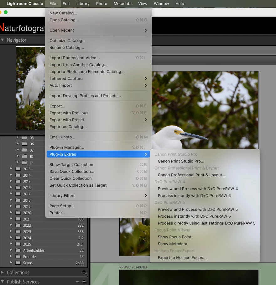

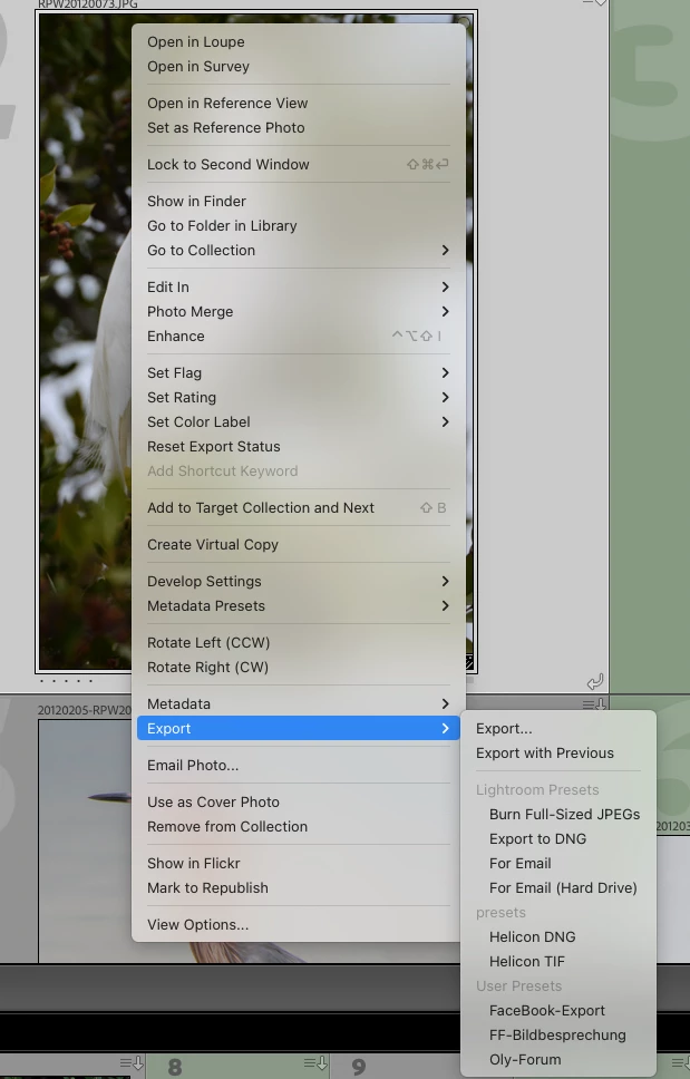

The first screenshot I've added shows the problem. There is no DXO PR5 in the list of Export.Options. The second one shows how it is doing well, but for me this is too circuitous to go to the pulldown menu and chose File - Plugin-Extras-DXO...
