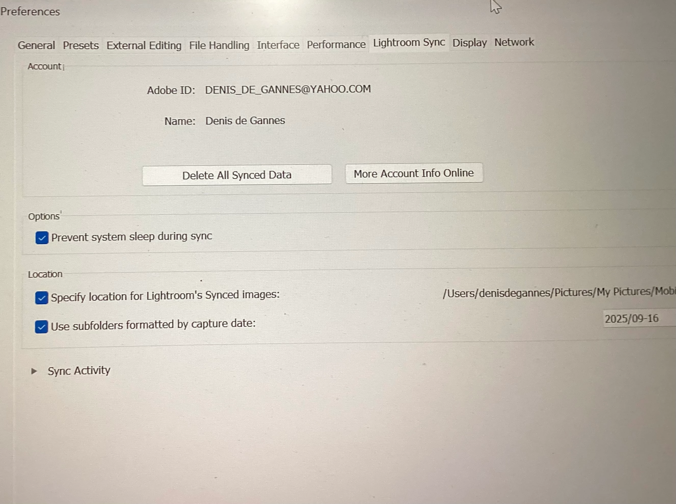

I am having a problem with where the Sync Images are being stored on my Win laptop computer ( LrC 14.5,1, Win 11 see info. On my Signature below).
The info in the LrC Preferences shows an incorrect file path ( I believe this path was inherited from a Catalog I was using on my iMac ).

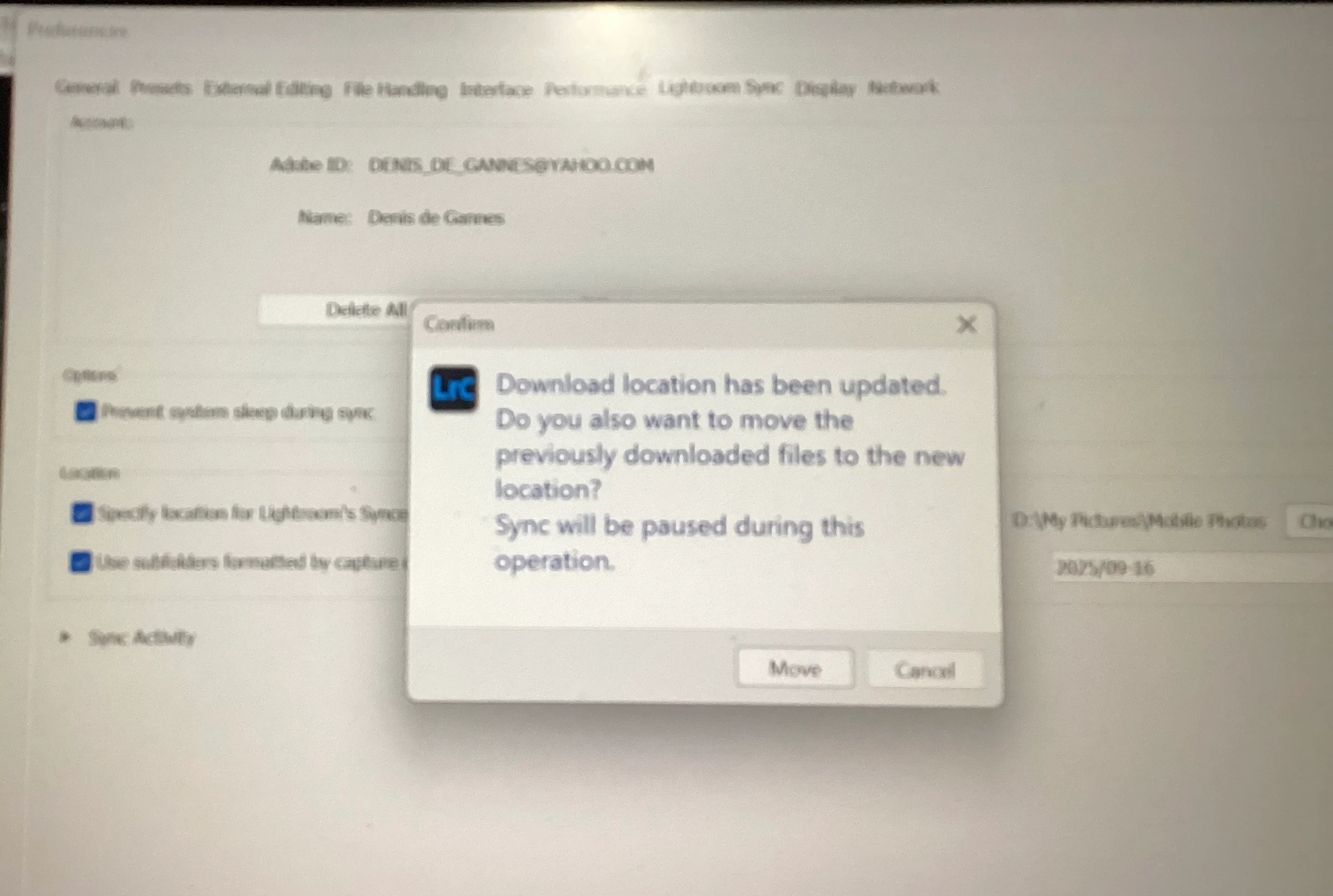

When I attempted to make a change to a new location on my Win laptop a popup indicates to copy the existing data this fails as the data was sent on a path that does not exist.
I am thinking of using the Delete All Sync Data option, but I am unsure.
Any Ideas?
See the screen captures below

Just clarifying I am attempting to Sync the images to an external drive, D://My Pictures/Mobile Photos.

Try this: First relink that Mac folder (using 'Find Missing Folder') to the corresponding folder on the PC. Then change the preference settings. Another option should be to click 'Cancel', so Lightroom does not try to move the existing images (no idea why that dialog does not have a 'Do not move' button).

Thanks for the thoughts, My iMac is limited to LrC 12.5 so I changed Syncing to the PC since the release of LrC 13.
It's almost two years since and there have been multiple changes to LrC specifically how Syncing to the Cloud, Upgrading of the Catalog and the application to AI functionality Denoise etc.
I have purged / deleted all the DNG files created with the earlier LrC application from the Catalog and replaced them with the new process. I do not wish the copy info from the iMac.
I will try the second option and see if that helps.
