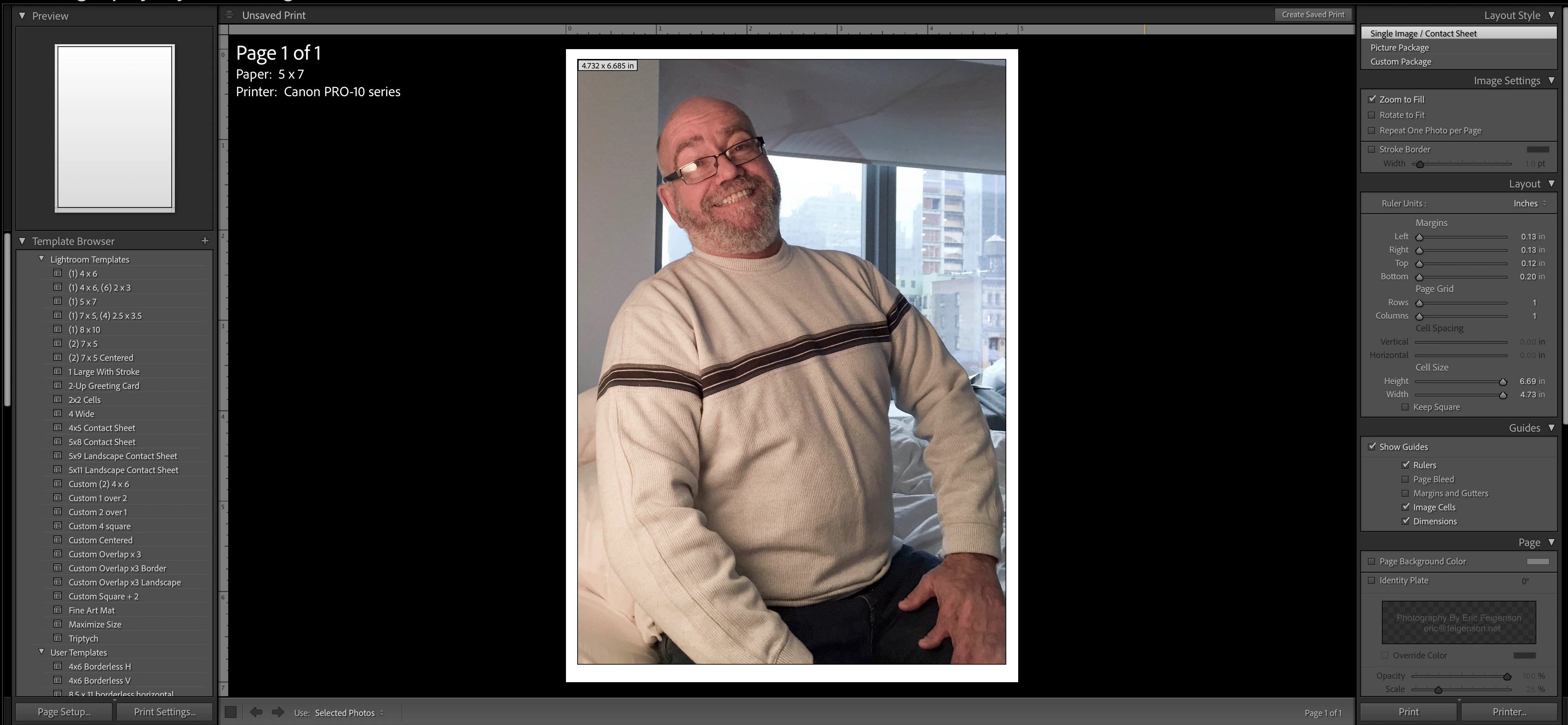

Hi... I'm trying to print from LrC 12.5 to a Canon Pro-10 with MacOS Ventura 13.5.2. I've been printing fine for a while, and "suddenly" I'm having issues. I'm not sure what has changed, other some MacOS updates. But I don't know at what point the problem started.
I'm trying to print a simple 5x7 print from an image that is 1938x2713 resolution. I've tried borderless and with border, and in both cases I get a postage-stamp sized image in the upper-left hand corner of the paper. Sample is attached. This also happens with 4x6.
The image in the Print module looks like it's correct. Screen shot attached.
I updated the printer drivers to the most recent on the Canon website (16.70.0.0) and the printer firmware is also current (2.031)
I have no problems printing from Photoshop 2024.
I'm hoping I'm doing something stupid... any ideas?
Thanks!
-Eric
Correct answer erflink
Bzzzzzt...! Time's up! The correct answer was given in the KelbyOne community forums.
And the answer is: The setting Print Settings..→Paper Handling..→Scale To Fit Paper Size was turned *off*. Turning it on fixed the problem. Now, why this caused the image to print in a tiny corner of the paper is beyond me, as Page Settings, Scaling was already at 100%.

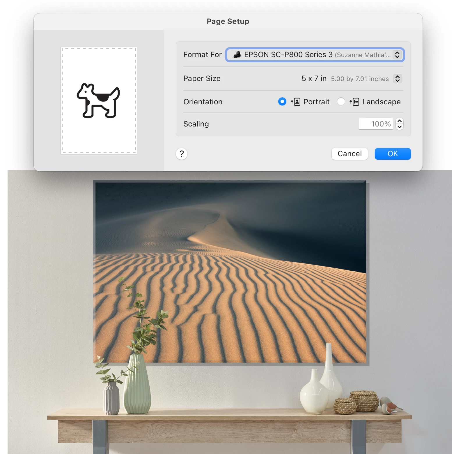

Suzanne Mathia
September 17, 2023
I just noticed that the Page Setup interface changed with Ventura. Did you update the Page Setp for the correct paper size?
.....Suzanne Mathia
erflink
erflinkAuthor
September 17, 2023
Hi Suzanne... Yes, I did notice that difference and set it appropriately... I think. I checked the way the photo appeared on the screen (bordered or borderless) plus the information in the upper right corner, where it says "Paper" and "Printer" whch was my main guide that the settings were corrent.
Plus, I was very happy to see the return of the dogcow!
Thanks for your reply!
