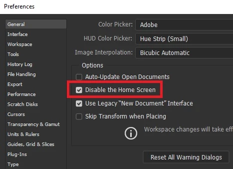

In the past there was a bug that pictures wouldn't load in Photoshop during the Welcome screen was enabled.
In the meantime this bug is fixed, but give it a try. Disable the Welcome screen in Photoshop and check if it's work.

March 12, 2021
Sorry, wont help
