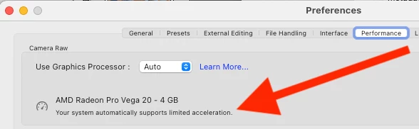

someone has a NVIDIA Quadro K6000 graphics card? I have a compatibility problem with this graphics card under Lightroom Classic, it tells me limited compatibility, it meets all the requirements in the prerequisites.
I have no problem with Photoshop, only with Lightroom
thank you for your help

I don't have any error message, just that the GPU is detected in a limited way, I have an older GPU card which is 100% detected but less performing with only 3GB of VRAM (Radeon HD7970) against 12GB for the Quadro K6000
I will try to use the NVIDIA Quadro Experience software to adjust the different parameters and see if it can solve my problem

"the GPU is detected in a limited way,"
Are you referring to what's displayed in Preferences > Performance > Use Graphics Processor?
If so, you could try this: Exit LR. In File Explorer, go to C:\Users\<username>\AppData\Roaming\Adobe\CameraRaw\GPU\Adobe Photoshop Lightroom Classic. Delete the file "Camera Raw GPU Config.txt".  Restart LR.  That will force LR to recheck compatibility of your GPU.  That sometimes fixes such issues.
