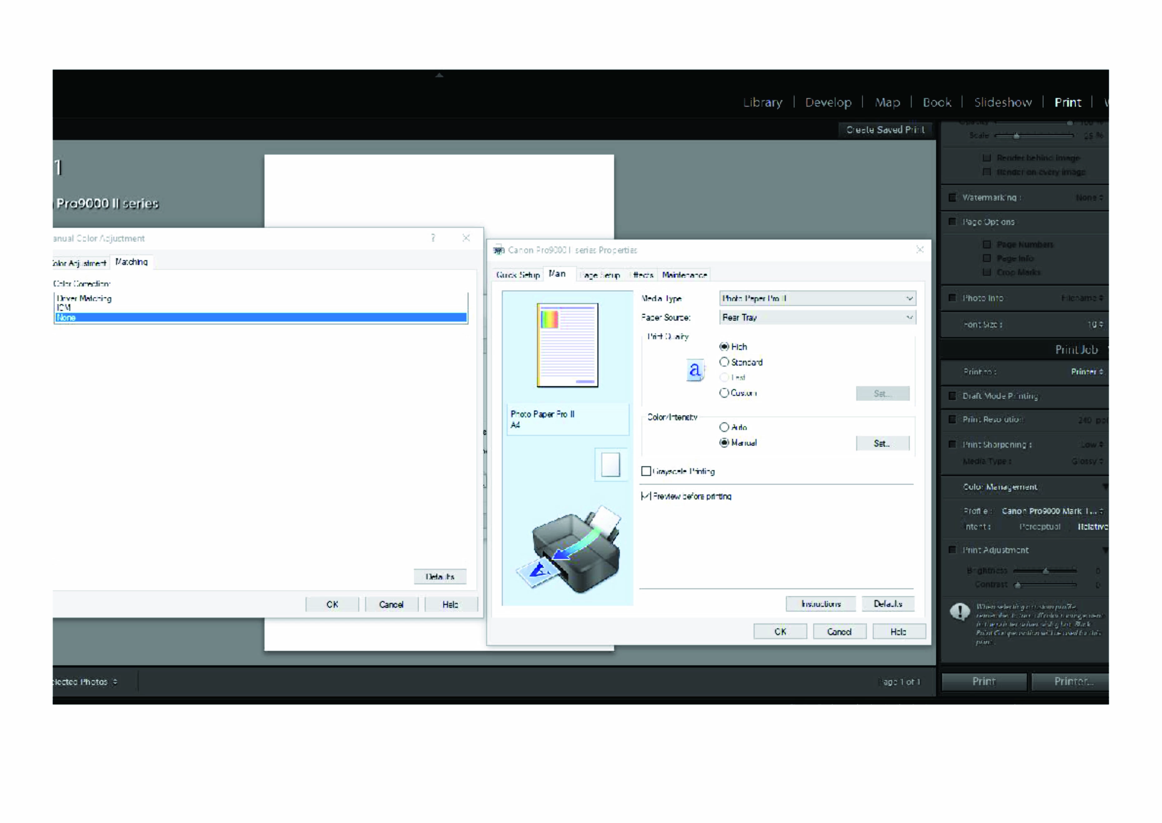

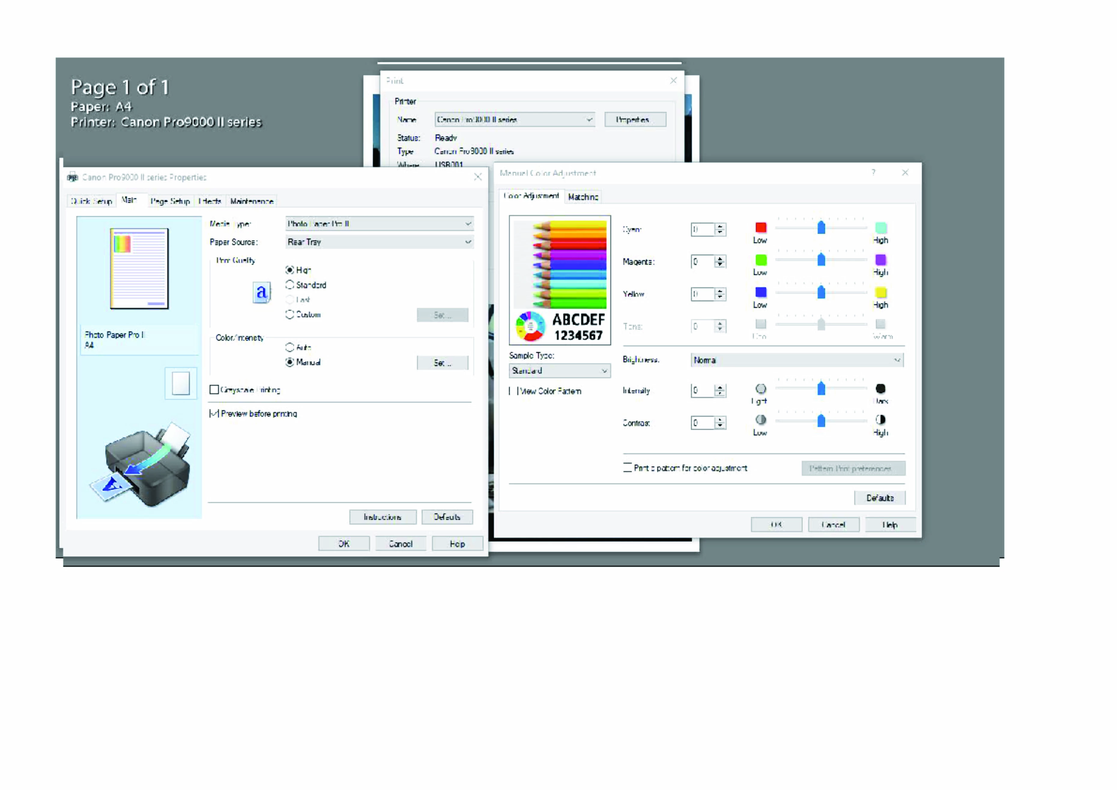

keithl49151645
January 8, 2018
I definitely have all color management turned off in the printer driver as you can see from these screen grabs
and
These settings give the problem but should not. I am aware of the "dual profiling" issue and a magenta cast. It is as though the driver is not taking any notice of the manual settings.
