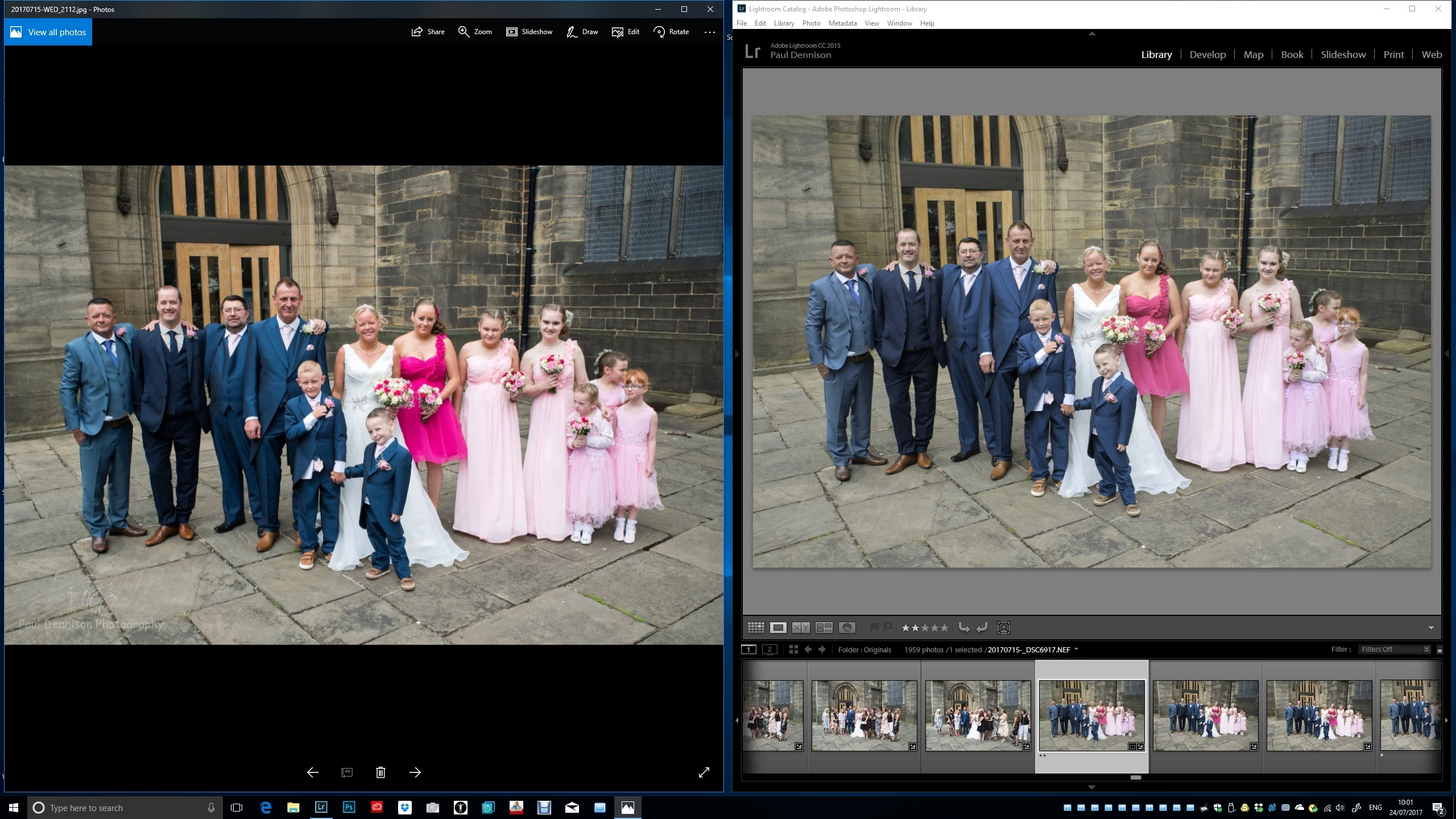

    The only way I can get them anywhere near is to drop the red saturation slider in the camera calibration tab, but there must be a way to get the colours exactly as I see them in lightroom.
    my camera is set to Srgb, my monitor is Calibrated and Srgb, I'm exporting in Srgb. I spend days editing them and get them just as I like them, to export and they look awful.  many thanks

    right weve got there
    July 24, 2017
    Hi and thank you, I'm just trying to find a way to do screen shots

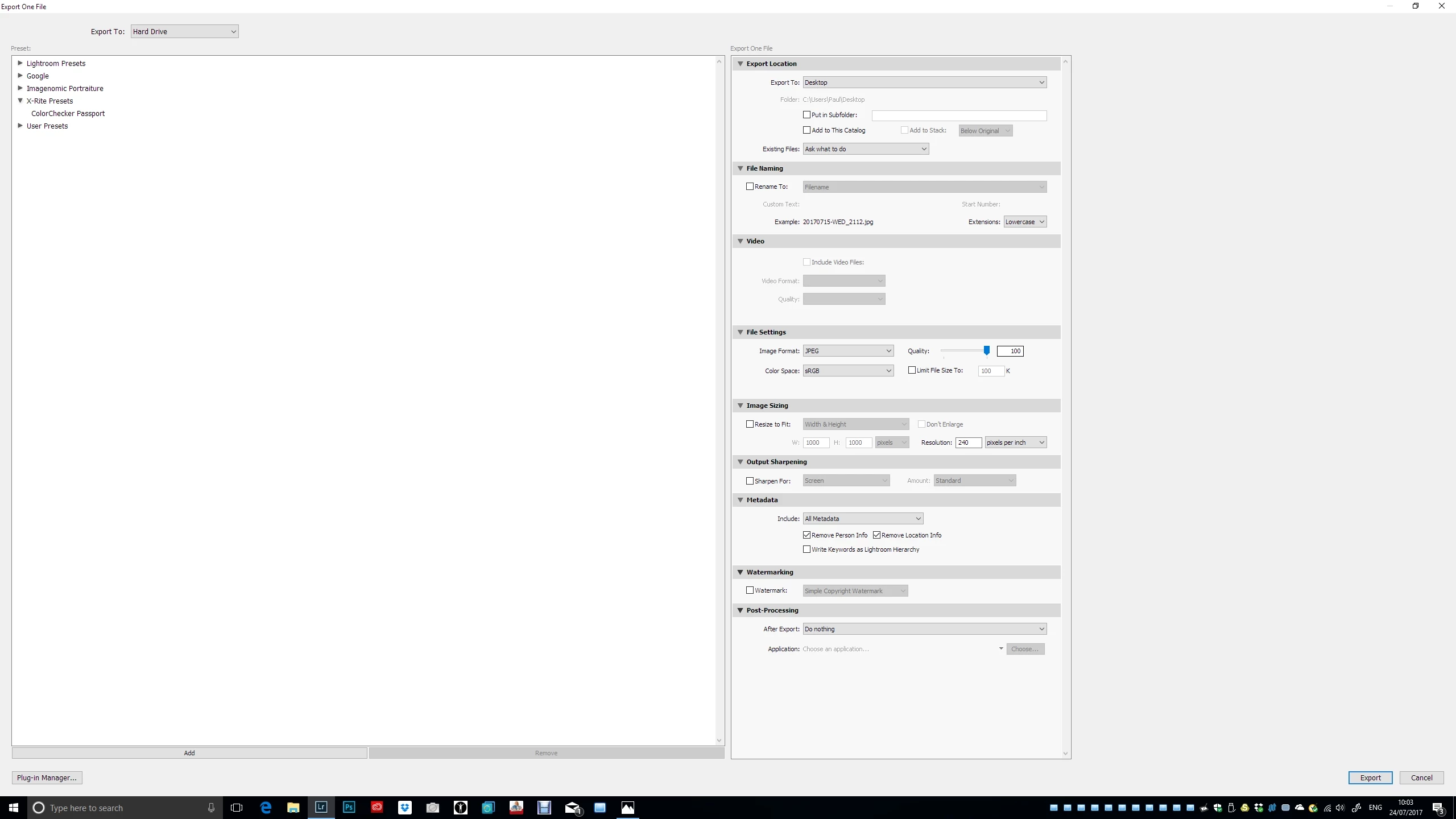

    Please post screen shots of the images and the export dialog window with the settings you are using.

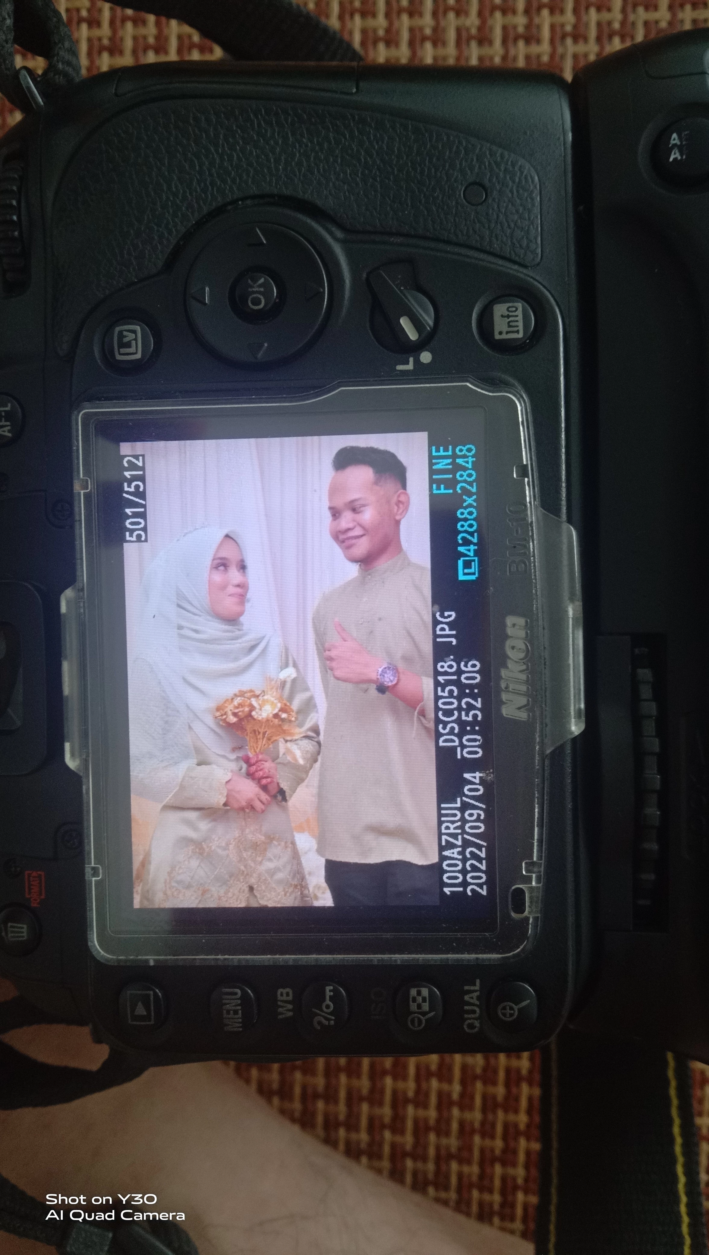

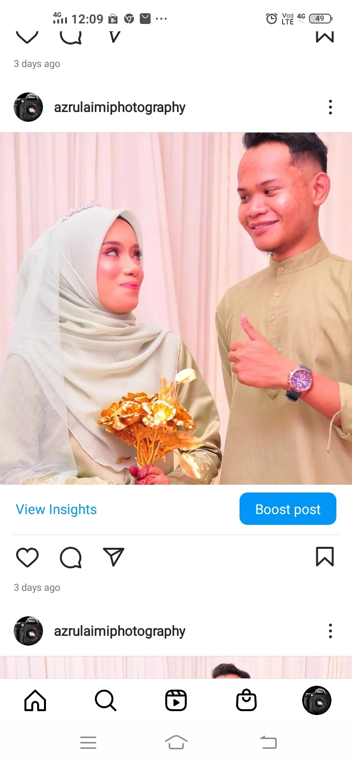

    September 13, 2022
    Sorry i couldnt get you.
    I also having a problem like you. In simple wird,the color of my images was changed to bad(over saturated/ skin tone is red ir pink eventhough the original image in a camera is in correct skin tone). What we should do? My clients also dispointed about the color which lead to my frustration too.
