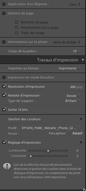

I have problems for printing photos with the Printing module of LR on my Epson printer SC P600
My screen is correctly calibrated with ColorMunki.
I use icc profiles for the photographic papers I use.

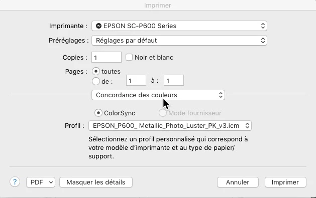

If I let LR manage colors, using a paper icc profile (e.g. EPSON_P600_Metallic_Photo_Glossy_PK_v3.icm), I get wrong colors e.g. yellow becomes a bit green, purple gets drak blue, etc, like if some additional profile was interfering.

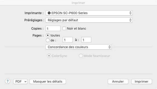

However if I let the printer manage colors and indicate the icc profile in the printer pilot, it seems ok.

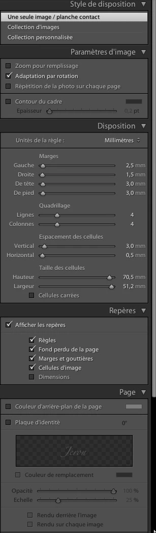

Moreover, the size of margins and photos that I indicate are incorrectly printed: image cells are enlarged (+1mm for 93mm), margins are truncated (more than 3mm on an A3+) paper, etc.
