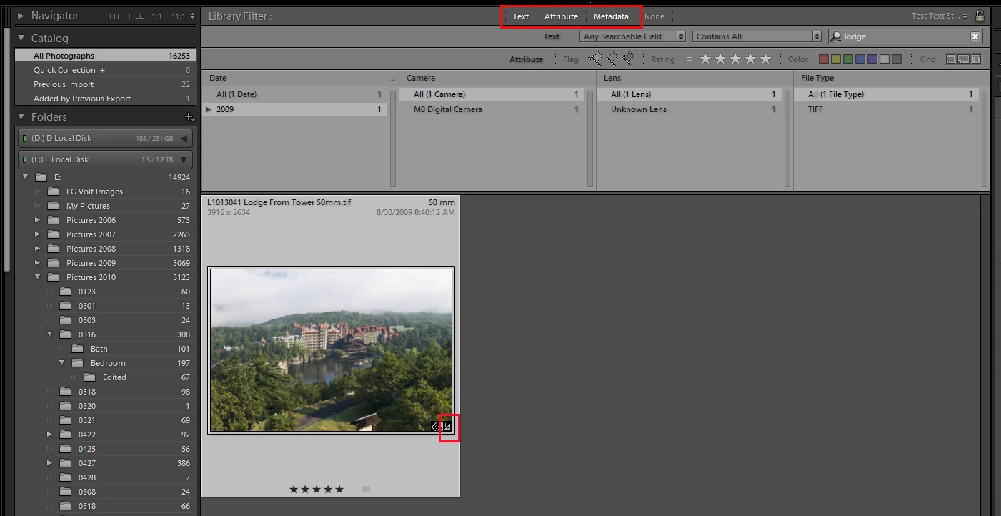

Aug 22, 2018 10:08 AM UTC
Do your images just Look Different or do they have the Icon set that denotes they have been edited?
In LR you see this. Icon in the lower right of the thumbnail in either the grid or filmstrip.
And in Bridge you see this icon.
Those icons only show if you have actually edited and image in LR of ACR. Normally changing the Default import/display settings won't add that icon to images. But applying a Preset will.
If you don't see that icon then as above it is more than likely a monitor profile problem.
You were asked to set the monitor profile to sRGB (not anything other than that). Did you do that? If Not then please do that and test.

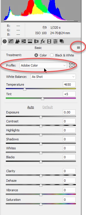

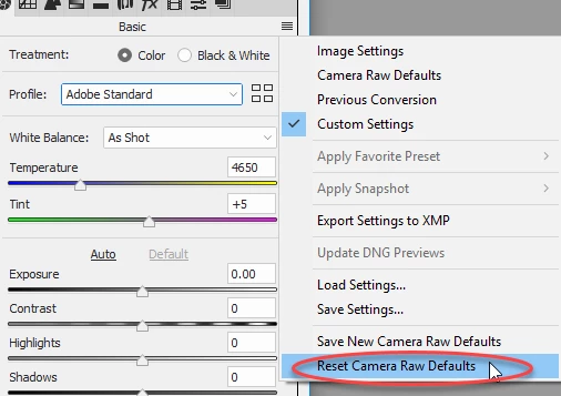

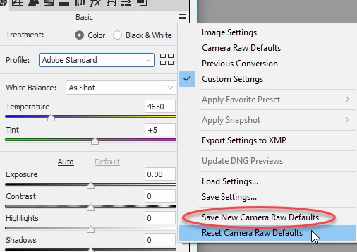

Aug 21, 2018 8:53 PM UTC
Is this just for new raw files that you have not previously processed. If it is , then have the defaults changed?
When you open a camera raw file for the first time the default settings are applied. This recently changed to a profile called Adobe Color
You can first Reset the defaults by clicking on the drop down (small circle above) and choosing Reset Camera Raw defaults
If you prefer, you can then alter the profile where shown in the first screenshot (it used to be Adobe Standard)
Then save new defaults by clicking on the small circle and choosing save new camera raw defaults
Dave
