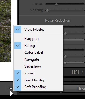

Hallo! Hat jemand einen Tip wie ich die Referenzansicht in Lightroom anschalten kann. Derzeit ist dieses Symbol von der Oberfläche komplett verschwunden und ich weiß nicht wo ich den finden kann.
Per Berntsen
February 23, 2022
If the Reference view icon is missing from the toolbar, click the little arrow on the right side of the toolbar, and make sure that View Modes is checked.
Per Berntsen
February 23, 2022
quote
Hello! Does anyone have a tip on how to turn on the reference view in Lightroom. Currently, this symbol has completely disappeared from the surface and I don't know where to find it
You have probably hidden the toolbar by accidentally pressing T. Press T again to display it.
You can also press Shift + R to invoke reference view.
