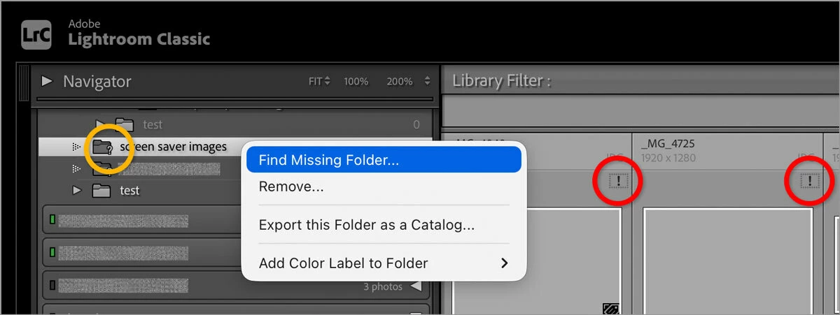

    Let’s confirm what you’re seeing, because there are multiple ways for folders and files to “missing,” so first we have to make sure what kind it is, as shown in the image below.
    1. If a folder is missing, there’s a question mark on that folder. This is circled in orange.
    1. If a file is missing, there’s an exclamation point on a file’s thumbnail icon, not on a folder icon. This is circled in red.
    1. If a subfolder is missing, the folder icon has an exclamation point in a black circle. This is not shown in the picture below.
    From your description, you should not be trying to relink any folders because what you are seeing is B, a missing file, right? Your screen shot shows that its folder does not have an exclamation point, therefore, you don’t need to relink the folder, you need to relink the files. Click the exclamation point in the top right corner of a file’s thumbnail icon to get an opportunity to relink it.
    If a folder is missing, its context menu has the Find Missing Folder command on it.
    If a folder is not missing, its context menu has the Update Folder Location command on it.

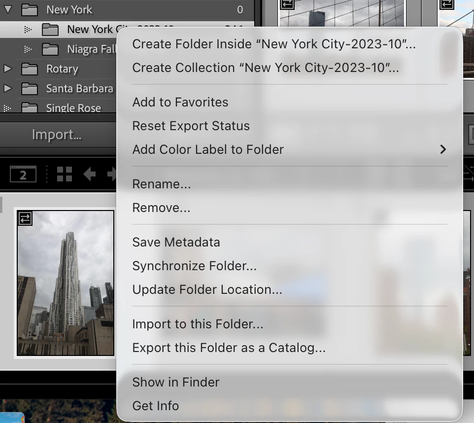

    The folder in your screenshot isn’t missing. ‘Update folder location’ is shown in the menus (the 10th menu), so I’m not sure why you say “it doesn’t do the trick”.
    It looks like you didn’t move that folder, but copied it. That explains why the original folder isn’t missing. If you moved the images however, then they will be missing. ‘Update Folder Location’ (select the new folder in the dialog you get) should solve that.

    Update Folder Location doesn’t do the trick. Here’s the dialogue box that appears when I right click. It’s the same for the parent folder.
