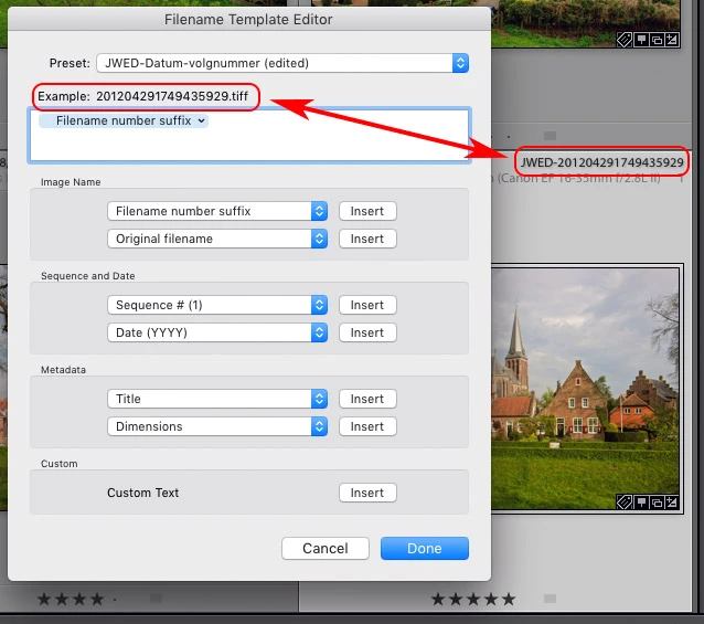

    I don't understand why you ask for advice, and then are too afraid to use it when you get advice. Simply use 'File Number Suffix' as I suggested. As you can see from this screenshot that will work just fine, no matter how many numbers the file name has. And renaming files from within Lightroom does not screw up the database.

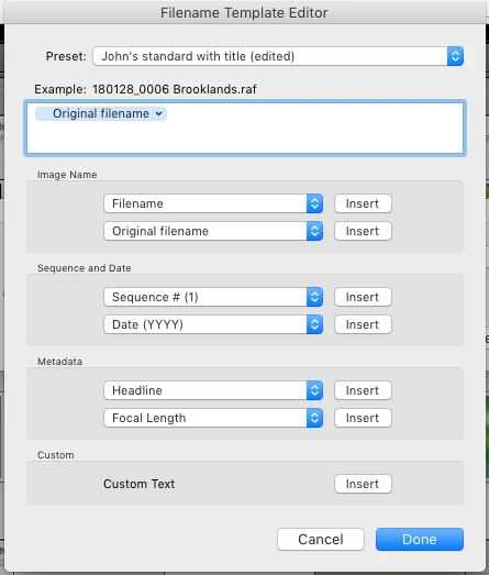

    In the original example, the original filename is "1010550.RW2". The Metadata does not appear to have a field representing the original filename, only the File Name. I see the example above of the Filename Template Editor, but I am not sure how to utilize it to remove the prefix "untitled-"?
    john beardsworth
    October 16, 2018
    The original filename field only appears in the Metadata panel if the file was renamed in LR, and you'd need to switch to the EXIF and IPTC view, as here:

    JohanElzenga
    October 12, 2018
    mrdavie99  wrote
    the "sequence number" is the photo number assigned by the camera, but the batch of photos will not be in sequence with one another.
    Just an idea that should work (try it on a single image first): Use a rename template that only contains 'File Number Suffix'.
