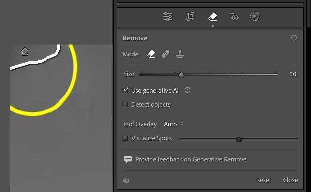

Remove objects in corners
Egal ob Kopierstempel, Reparaturpinsel oder Generatives Entfernen: Befindet sich in einer Bildecke ein Objekt (Rest einer ins Bild ragenden Softbox) bekommt man es mit keiner Methode sauber weg, egal welche Werkzeugeinstellung man vornimmt - klei, gross, weiche Kante, volle Deckkraft..

Remove quickly removed the object from your screenshot:
Removing objects from the edges of photos requires a little extra attention:
1. Uncheck Detect Objects (on by default in LR 14) -- it doesn't work well, especially with skinny objects and along the edges of photos.
2. Undo any Crop, Lens Correction, and Transform, apply Remove, then reapply those commands. Remove tries to match the unselected cropped-out pixels.
If this doesn't help, please attach a full-resolution JPEG exported from the unmodified original photo (not a screenshot), so we and Adobe can see the issue in detail. With nearly every of the several dozen problem photos posted here, we've been able to show how to quickly remove the desired objects.

Okay, dann darf ich bis in die Ecken nur dann generativ entfernen, wenn das Bild noch im Ursprungszustand ist, also ohne ausgeschnitten oder per Upright transformiert worden zu sein. Danke
johnrellis
Dec 6, 2024 7:34 PM UTC
@hesselbacher@web.de: "then I can only remove the corners generatively if the image is still in its original state, i.e. without being cut out or transformed using Upright."
That's right. Generative Remove would be a lot less confusing if the user interface warned users that Crop, Lens Corrections, or Transform has been applied.  Inexplicably, Remove does this for Lens Blur but not the cropping commands (which are used much more frequently).
