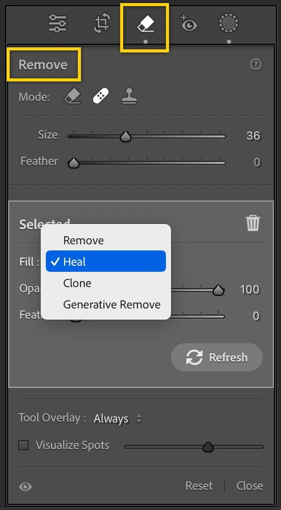

Make sure Remove is selected. This is in Lightroom Classic 14, where healing is one of the modes of the Remove tool.

The fact that it’s the Remove check box might be less intuitive for those of us who have used Lightroom Classic for a while, because we’re not used to that being called Remove. But the fact is, as Adobe has been adding more Remove features (like Generative AI Remove, and the upcoming removal options for people and reflections that are currently being tech-preview tested in Adobe Camera Raw), they have re-organized these tools. Now Heal has become one of the options within Remove. Based on that logic, a heal correction is under Remove, therefore we want to look for Remove. As we get used to understanding that Heal is now one of many options for removal, from this point forward this should become increasingly intuitive.
