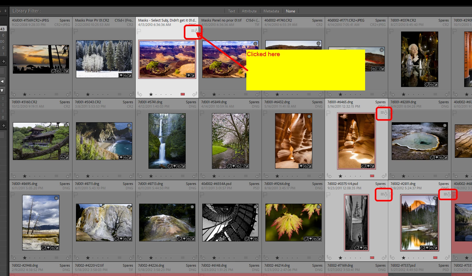

For the last several major releases, "saving metadata to files" does not stick on some images

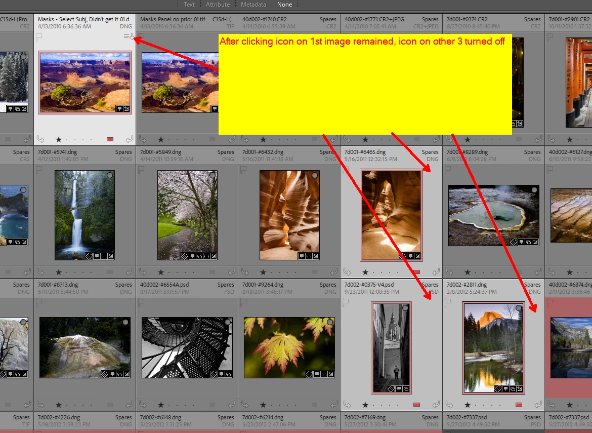

If I select a bunch of images in the grid which of the "metadata needs to be saved" icon showing and perform a "save metadata to disk" operation, the icon turns off but a moment later on some, but not all, of the selected images, the icon turns right back on.
REMEDIES TRIED (non worked)
  1. Turned off Cloud Sync
  2. Disabled all plugins
  3. Tried DNG files, JPG files, PSD files, TIFF files.  No correlation could be found for which images have the problem and which don't.
  4. Tried one image at a time vs several at a time
  5. Does not seem to matter if the image is in a collection or not
  6. Does not seem to matter if the image is in a Publish Service or not
  7. Saved a copy of one problematic image to a new folder using File Manager.  Then created a new empty catalog and imported that one image using the "Add" mode.  The image showed up in the "previous import" special collection with the "Metadata needs to be saved" icon already turned on.  This was a DNG type image

Have copied a test image that has this problem to the  "C" drive and imported it into LrC.  It arrived in Lrc with the "metadata needs saving" icon turned on.  Click the Icon does not clear it.  using menu "Save medata data to file" does not clear the icon.

Does the icon appear even if the metadata is "Up to date" ?
There is a long lasting bug with Lr metadata detection.
Perfectly up to date files will be marked as not up to date, or changed externally.
When auto saving into XMP and/or manual supposedly fail, and the photo metadata keeps appearing as not "up to date" then the solution is to Save Manually then "Read Metadata from file"
