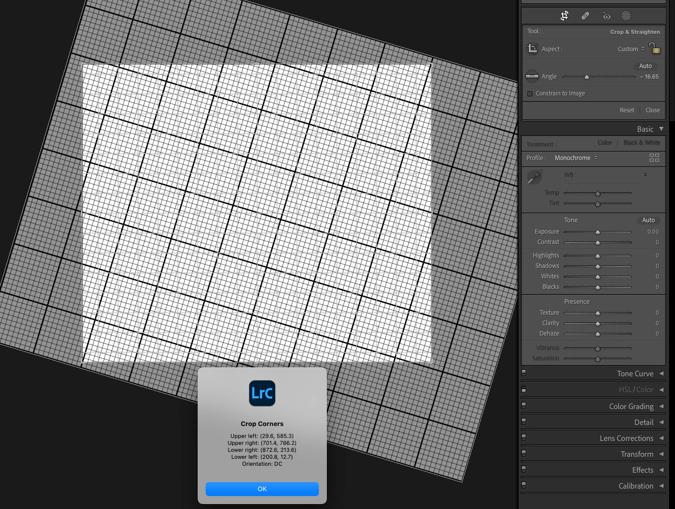

I've attached a script "crop-corners.lua" that displays the coordinates of the crop rectangle for the current photo. The top of the script explains how to install and run it. I've also attached a 1000-800 pixel image with 100 x 100-pixel grid, to make it easy to observe the results of crop computations:

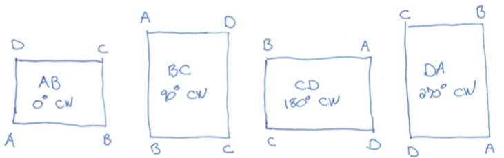

In the SDK, photo:getDevelopSettings().orientation provides the stored orientation as a two-letter code with the letters A, B, C, and D. To interpret the code, label the corners of the stored array of pixels as:
The orientation codes for the rotations of 0, 90, 180, and 270 degrees clockwise are:
The code is the two letters along the bottom edge. If the photo is mirrored along the vertical axis, then the letters will be reversed: BA, AD, DC, CB.

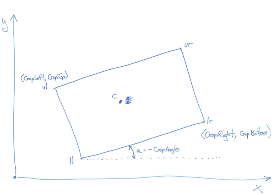

LR represents a crop rectangle with these numeric fields in photo:getDevelopSettings(): CropLeft, CropTop, CropRight, CropBottom, CropAngle. The upper-left corner of the rectangle is (CropLeft, CropTop) and the lower-right corner is (CropRight, CropBottom). These coordinates are in the develop coordinate system, in which x- and y-coordinates are in [0..1], with (0, 0) being the upper-left corner. They represent coordinates with respect to the array of pixels stored in the photo before any orientation is applied.
CropAngle specifies the amount the crop rectangle has been rotated around its center (positive = clockwise, negative = counterclockwise). Here I refer to code angle a = -CropAngle (positive = counterclockwise), to match the conventions of high-school math).
Define the develop pixel coordinate system as pixel coordinates relative to the array of pixels before orientation has been applied. The x-coordinates are in [0..w] and the y-coordinates in [0..h], with the origin (0, 0) in the lower-left corner, where w and h are the width the height of the array of pixels. (Most graphics libraries use the upper-left corner as the origin, but I use the lower-left so that high-school math recipes I find online don’t need translation.)
Here are the steps to obtain the pixel coordinates of the crop rectangle's corners. Refer to this diagram:

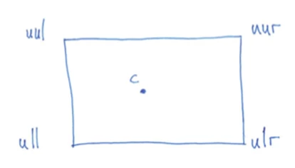

5. Next, level the rectangle and compute the “unrotated” corners uul and ulr by rotating ul and lr around c by -a degrees:
uuld = pointRotate (uld, cd, -a)
ulrd = pointRotate (lrd, cd, -a)
6. Compute the other two unrotated lower-left and upper-right corners:
ulld = {x = uuld.x, y = ulrd.y}
uurd = {x = ulrd.x, y = uuld.y}

Update: The new version of the script also shows how to translate corners in visual pixel coordinates back to the develop coordinate system used internally by LR.
