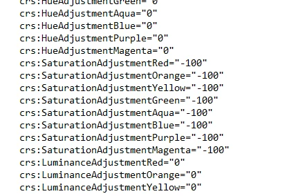

As an example, here's an extract from my preset for B&W conversion the way I prefer to do it.
Since only adjustments of this nature are present, it can be easily worked out that only the HSL adjustments checkbox was involved.
