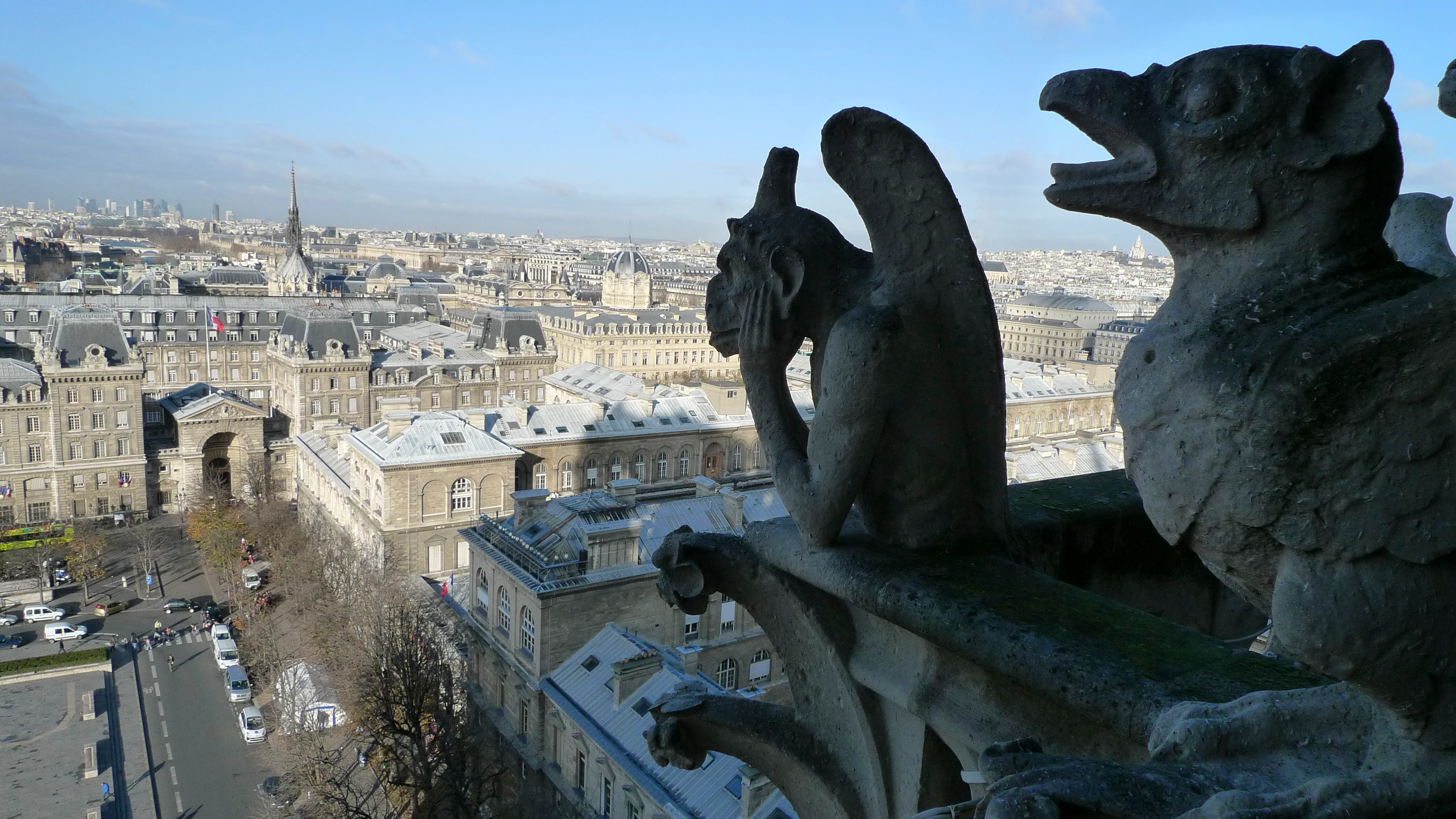

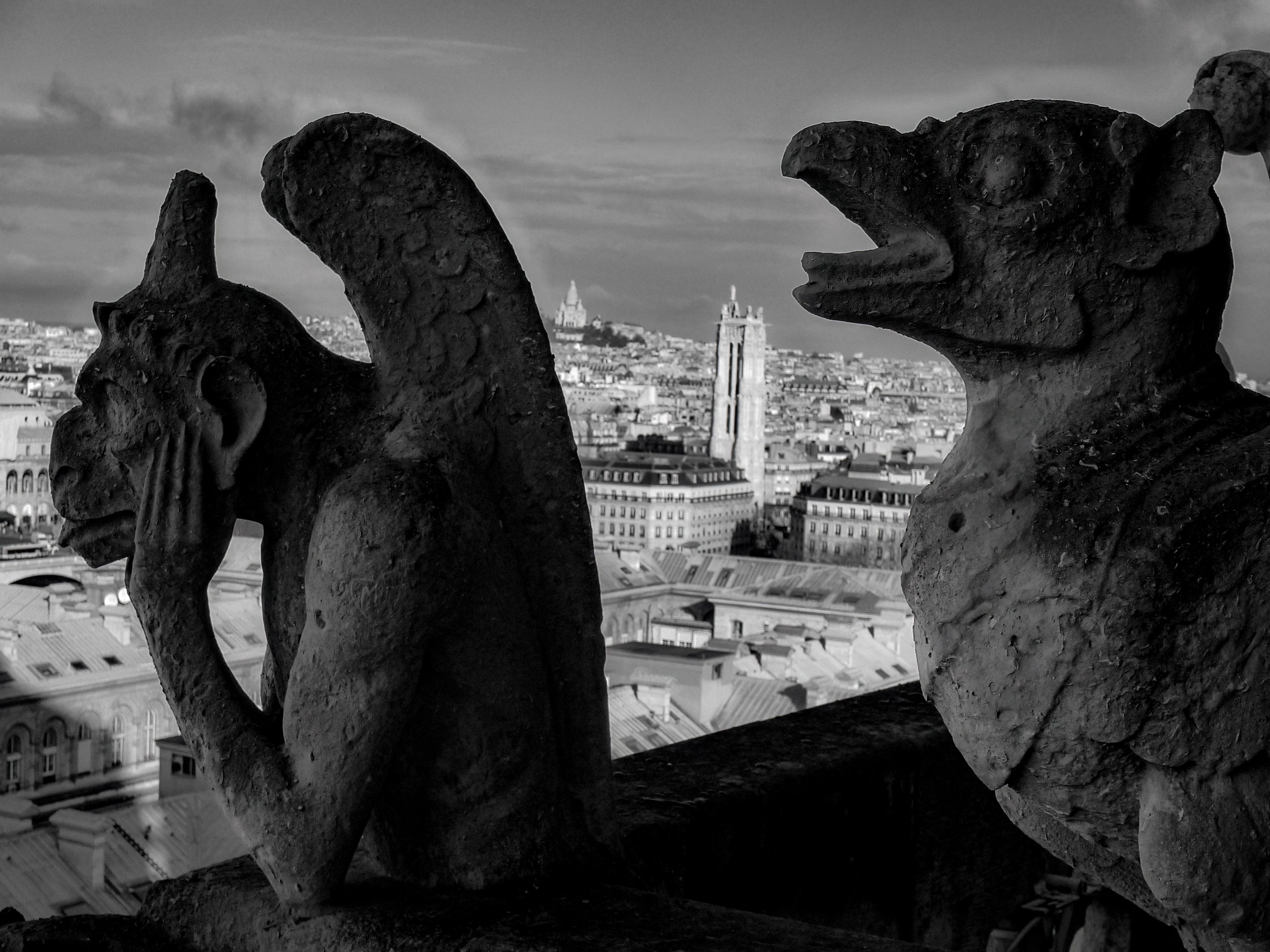

Hi Srishti,  After some digging into my library I discovered that the white fringe on the high contrast person is likely from my camera.  It seems to have been there in the jpg from the camera.  Which raises the question  "how do I remove it.?"
You can the artifacts in both of the attached photos. There is a white aura around the head of the figure at right.  It is really noticible in the B&W file.
So to answer your questions:
  • I am on a 2019 iMac running Sonoma 14.2.1
  • It only happens occasionally.  It has happened with images from more than one camera.
  • I imported the color jpg into LrC.  The B&W wend out as a jpg and was created with the help of Nix 6 Dfine and Nix 6 Silver Efex Pro. It came back to me as a .tif where the issue was strongly evident.
  • The issue surfaced a while back, too.
Any help you can give to remedy this using LrC or PhotoShop will be greatly appreciated.
