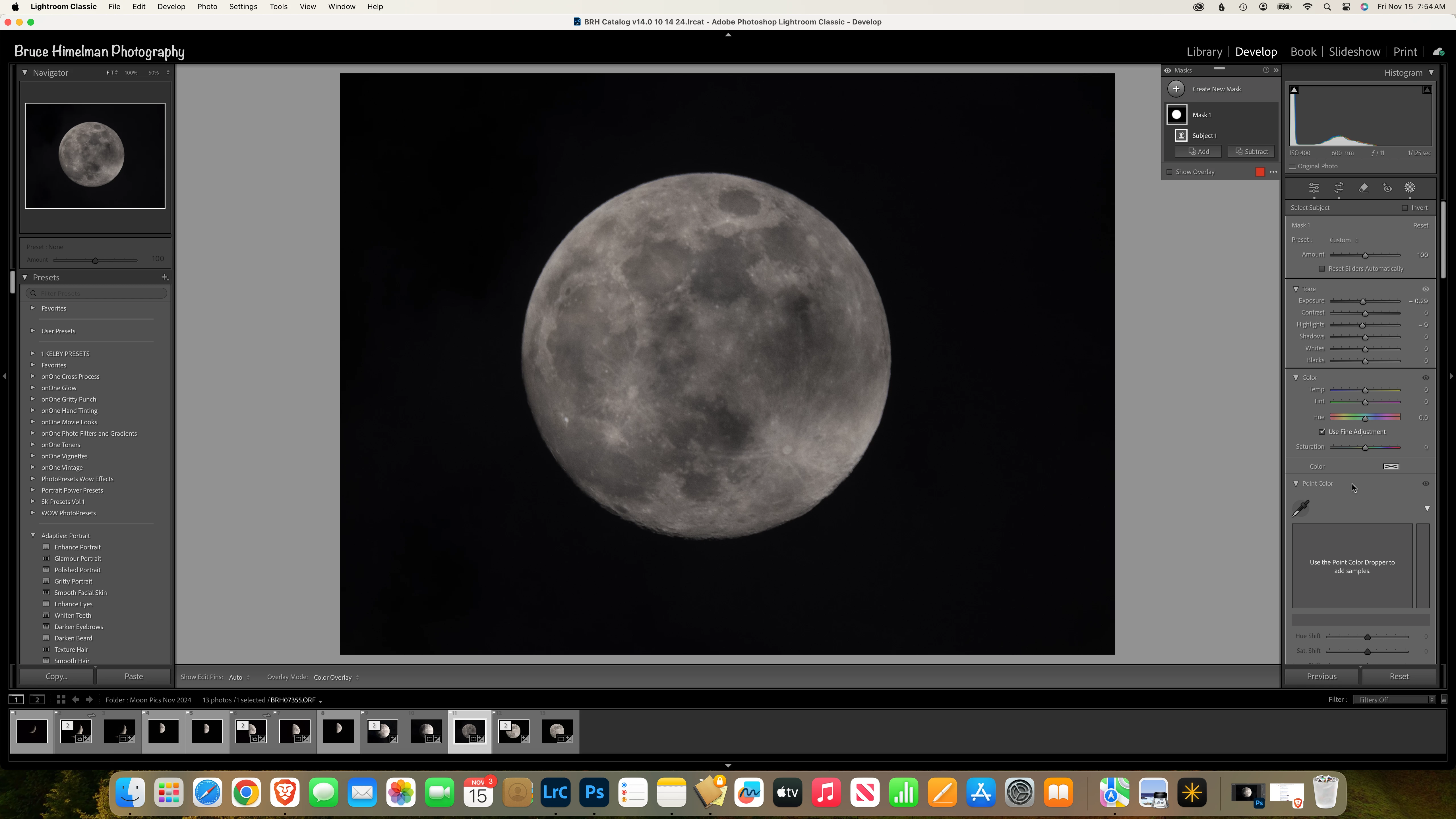

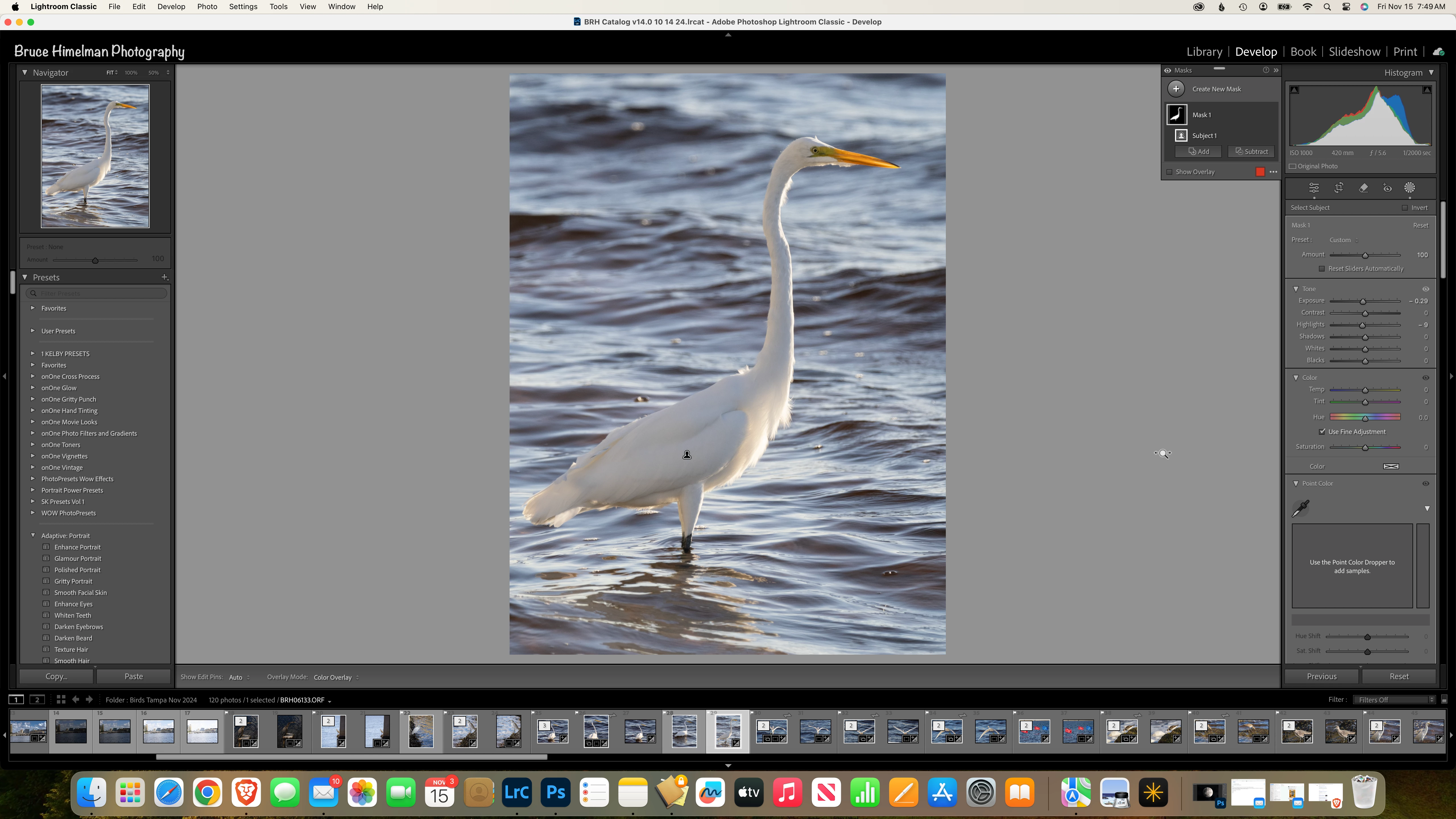

Select Subject In LR Classic: adjustments made upon opening
In LR classic ( lastest version) when choosing the masking option of "select subject" there are adjustments already here to exposure and highlights. It is as though a preset is there, but I did not create any presets for "select subject". Anyone else having this problem? Would like a fix for this. Thanks
