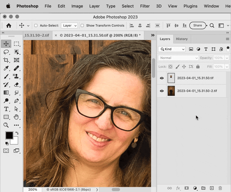

I'm definitely not able to explain properly. I attached an uncropped photo and a cropped one. Both were subjected to a sharpening amount of 85 in Lightroom and exported. First thing I noticed is that I can't align them in Photoshop which means that the images are not identical, although are from the same photo. I did my best to align both and then cropped the full res based on the LR crop. The size of both exported TIF (the Lightroom cropped and the full res cropped in Photoshop) was almost the same (the difference was propbably due to the fact that I couldn't align them), which means that Lightroom crops AFTER sharpening. I guess this also applies to noise reduction.

I understand that the two images you posted are JPEG format and not the original TIFF format, but even then, after aligning them precisely in Photoshop using the common Difference mode technique, there seems to be no difference between the cropped and uncropped versions. Neither image was resized or resampled, simply layered 1:1. This is what is shown below:
1. The two images are added to the same Photoshop document, not yet aligned.
2. The cropped image layer is set to the Difference blending mode, because this mode reveals any differences between the selected layer and the layers behind it. Black pixels indicate no differences between the layers.
3. The cropped image is repositioned, to manually align it with the uncropped image. At one position, the cropped image appears completely black. This indicates two things: There are no differences between the images, and because there is no difference, they are perfectly aligned. This is why many people use the Difference mode to manually align layers, especially when automatic alignment fails.
(The image colors may look posterized in the animation. This posterization is not in the original animated GIF file; the forum software seems to recompress this format.)
No difference is what I would have suspected, because of how sharpening works (hopefully this is correct); I think none of the following Lightroom Sharpening options are related to or affected by changing pixel dimensions such as by cropping:
  • Amount is a sort of amplitude which I think is not spatial, so the same amount should produce the same result regardless of pixel dimensions.
  • Radius is related to nearby pixels, so if neither version of the image was resampled, Radius should have the same result before and after cropping. (However, the identical result of the same Radius value can be perceived to be different if the cropped version is reproduced at a different pixel density (ppi) than the uncropped version.
  • Detail is related to detail frequency, so again its result should be the same for a cropped and uncropped version.
  • Masking is, I think, similar to Radius in that it’s going to be about nearby pixels and not affected if the overall pixel dimensions change.
And the reason others asked you if sharpening was applied in the Export dialog box is because by its nature, output sharpening can be affected by pixel dimensions and output targeting, for example if both versions were exported with output sharpening set for printing.
