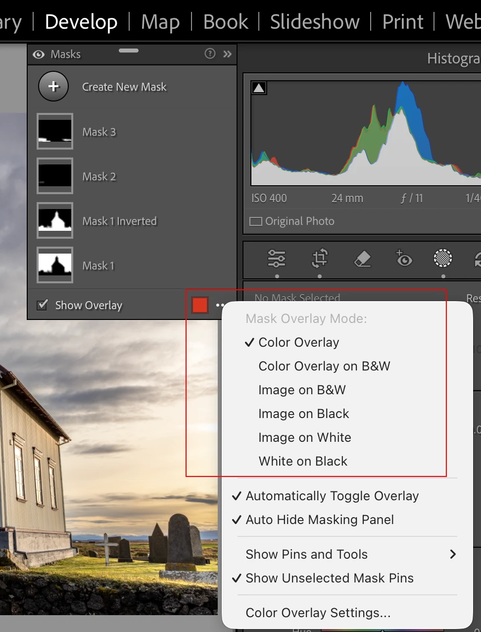

    Aug 9, 2026 12:49 PM UTC
    You may have enabled the B&W overlay under the mask overlay 3 dot menu. See below screenshot for how to select Color.
    If above doesn’t help, then post a screenshot showing the B&W mask.
