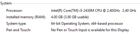

charlesc3183991
Feb 19, 2019 10:14 AM UTC
I'm a non technical person and have the Slideshow Greyed out problem.  Could someone please tell me if the issue is that my laptop is not powerful enough:
Many thanks in advance.
Charles
