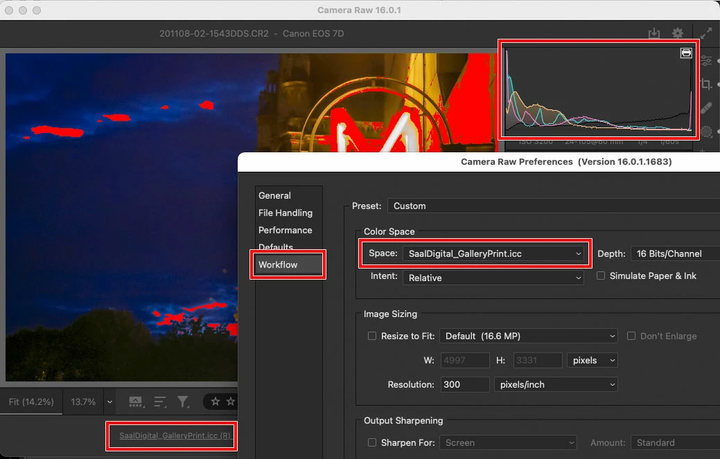

There is a way, but it is unfortunately rather complex, and probably not easy for a beginner.
The root of the problem is that Adobe Lightroom Classic does not support CMYK profiles. However, Adobe Camera Raw does. So, if your file is in a format that Adobe Camera Raw can open, you could soft-proof in CMYK using that. The specific reason to use Camera Raw is that it can send edits back to Lightroom Classic to apply them to the original file, because Lightroom Classic and Camera Raw use a common metadata format for edits. So you can edit while soft-proofing CMYK, and send the edits back to Lightroom Classic.
But if you are a beginner, and especially if you have not studied the basics of color management/profiles and how they work in different Adobe applications, most of the steps below may be a challenge to understand. But this is how I would do it. Important: These steps assume it is a camera raw or DNG file. If it’s in another format such as TIFF or JPEG, let us know because additional steps would be needed.
1. In the Library module in Lightroom Classic, choose Metadata > Save Metadata to File. This saves the photo’s current edit settings in XMP format so that other XMP-compatible applications can read them.
2. Choose Photo > Show in Finder. Lightroom Classic pops open the Mac Finder desktop and shows you the image selected in its folder on the desktop.
3. In the Finder, drag the image and drop it on the Adobe Photoshop application icon. If it’s in a format that Camera Raw is set to open, it opens in the Adobe Camera Raw plug-in.
4. Click the underlined settings at the bottom of the Camera Raw window.
5. In the Camera Raw Preferences dialog box that opens, in the Workflow panel select the profile in the Space menu, set any other Color Space options as needed, and click OK. Camera Raw is now soft-proofing through the profile, and the histogram changes to a soft-proofing histogram, with a gamut warning button that looks like a printer because the proofing color space is CMYK. If the button is selected, all clipped colors are relative to that profile, such as the red areas in the picture below.
6. Make any adjustments needed.
7. When you finish, click the More Settings menu on the right, the one with the ellipsis (…), and choose Export Settings to XMP. This updates the edit metadata sent from Lightroom Classic.
8. Click Done, and you can now exit Photoshop if you want.
9. Switch back to Lightroom Classic, and with the same photo selected, choose Metadata > Read Metadata from File. Lightroom Classic picks up the edits modified by Camera Raw, which should now be applied to the image.
Below is what Camera Raw looks like when it is set up for your profile. You can see the differences in the histogram, compared to when using a RGB color space.
