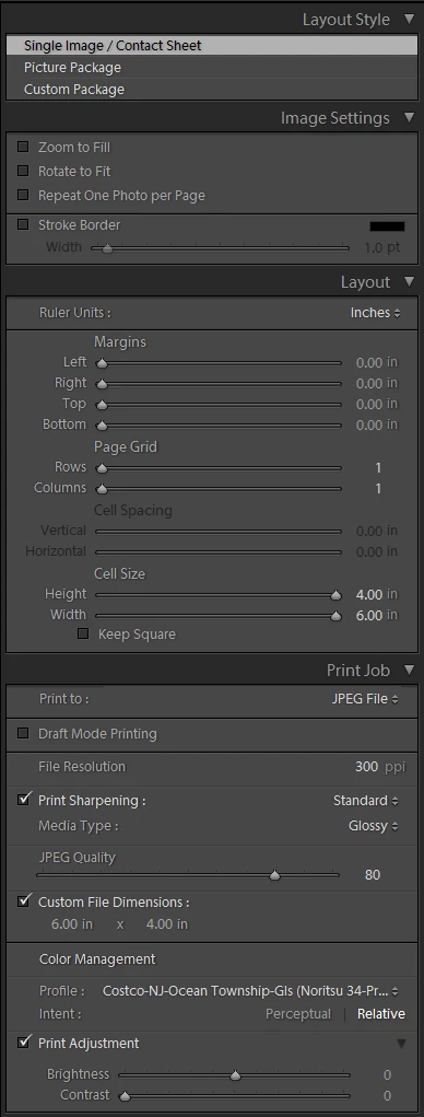

In LR, if there are any colors out of gamut for a specified destination color space (like a printer profile), some people will recommend to turn down the saturation (or mess with the HSL settings) in order to fix it. However, simply exporting it with the destination color space embedded in the saved image file will automatically convert all the colors into that space. Which means then you can load the exported image back into LR and verify that indeed, the Destination Gamut Warning has disappeared entirely (no more red). What's more is that the results are almost always superior than what you could achieve manually by editing HSL sliders anyway!
So my question is this: Why isn't there an option to do this conversion in LR, without having to export an image and then load up the exported file? It just seems like a lot of extra steps for something that can be done in a click of a button. It seems very odd that exporting and importing a file is necessary to do the automatic conversion.

    If using the HSL tool is not recommended, what is the recommended way to address large portions of the image being out of gamut?
    March 19, 2017
    Generally do nothing. Only if you lose detail in those areas, you should use some localized edits (negative saturation generally) and that should fix it. Considering the clipping part, It depends on how the lab works whether there is an advantage. If they insist on doing the conversion from whatever you deliver, you can use their profile to check for problems (again an out-of-gamut warning is not generally a problem) and color shifts that you might want to correct. If they allow you to deliver files in their profile, there is some advantage in doing the conversion yourself as you avoid a conversion step that can potentially induce color banding. Consider the hypothetical case that you would send them a file in 8-bit adobeRGB vs a 8-bit printProfile. What happens in the first case is that you go linear 16-bit ppRGB->8-bit aRGB->8-bit printProfile, in the second case you go directly 16-bit ppRGB->8-bit printProfile. It is possible that the intermediate step to adobeRGB or sRGB actually blows some colors that are printable in the final destination and you also can get bit-conversion errors that can cause banding.

    IMHO, it would still be a very useful and handy feature to be able to convert to different color space without exporting. Even if it's technically not the absolute "correct" way, it works for me in 95% of cases when a "targeted approach" is too time consuming or unnecessary.
