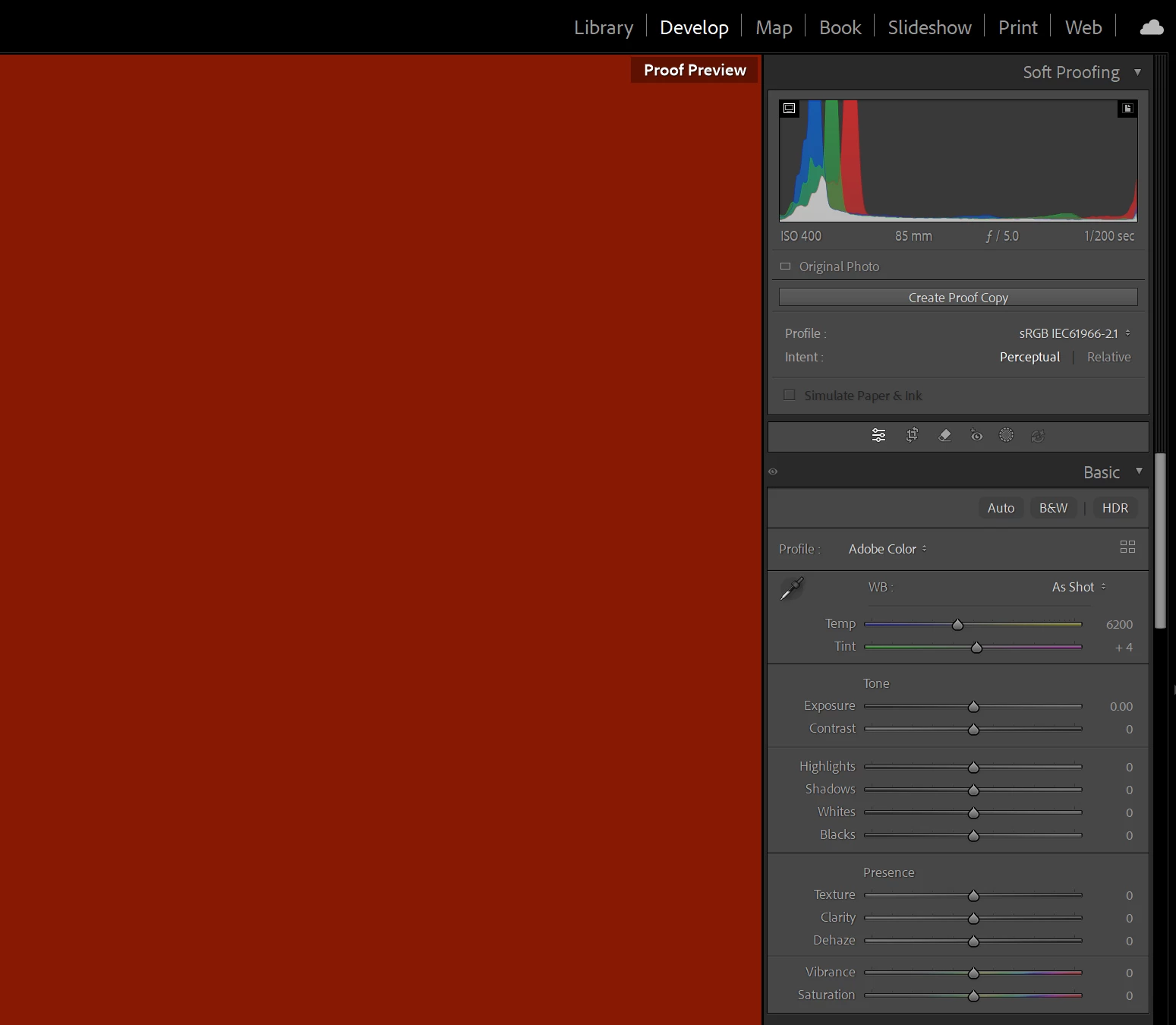

Soft proofing Monitor Gamut Warning is broken
When Soft Proofing viewing the monitor gamut warning just change the entire display area to red. Note this also happened in 15.3. Destination gamut warning works correctly.
Windows 15.3.1 release, everything up to date.

    ShootingPixelsAndyCorrect answer
    May 31, 2026 10:27 AM UTC
    Culprit found. Windows Automatic Colour Management is silently turned on whenever the display is set to 10-bit. This clamps everything to sRGB and I guess upsets Lightroom in the process. Turning off ACM  via Settings > System > Display > Colour Management restores correct gamut warnings but the other issue I previously reported of the image getting slightly dark remains.

    ​@ShootingPixelsAndy Profile was created using Calibrite Profiler and works fine in 8bit.
    If you set the profile to sRGB and use 10 bit, does the problem occur?

    May 31, 2026 6:46 AM UTC
    Yes.
    2 different machines
    2 different displays (desktop and laptop)
    2 different graphics cards
    10-bit always causes the issue.
    Does 10-bit work for you? Anyone else?
    Could it be related to a similar issue I reported 6 months ago with Soft Proofing?

    Happens on two different machines. Profile was created using Calibrite Profiler and works fine in 8bit.
    Quickly test if it happens when you set your gfx card to 10bit John
    ShootingPixelsAndy
    May 30, 2026 10:19 AM UTC
    Little update, this only happens when the GFX card is outputting 10-bit colour depth.
