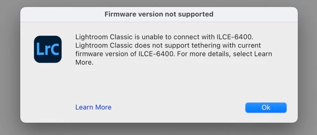

Sony A6400 support in LR version 14.2, not working for me
Hello, I have updated Lightroom to version 14.2 where you say that it already supports the Sony a6400 when tethering. But when connecting LR it says that this firmware is not supported, even though it is the latest version 2.0.
macOS Sequoia 15.3.1
LR 14.2

Feb 28, 2025 6:23 PM UTC
It hasn't been updated on the page yet, but since update 14.2, a6400 support is listed directly during installation.   https://helpx.adobe.com/camera-raw/kb/camera-raw-plug-supported-cameras.html
dj_paige
Feb 28, 2025 6:34 PM UTC
That page means the A6400 is supported by ACR, meaning that LrC can read and edit your RAW images. It does not mean that tethering is supported; in fact tethering is not supported at this time.

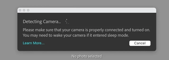

Hi, thanks for reaching out and we're sorry about the trouble!
Please try adding Lightroom Classic to Full disk access and Accessibility on your Mac to check if that makes a difference. You can check the steps here: https://adobe.ly/4i1C9Mm
You can also check out some troubleshooting steps here: https://adobe.ly/4i1C9Mm
Let us know if this makes a difference!
Nikunj
Feb 28, 2025 5:46 PM UTC
Thanks for the response, but it didn't help. In the settings I have full disk access for both Adobe Lightroom and Photoshop, as well as access to folders.
