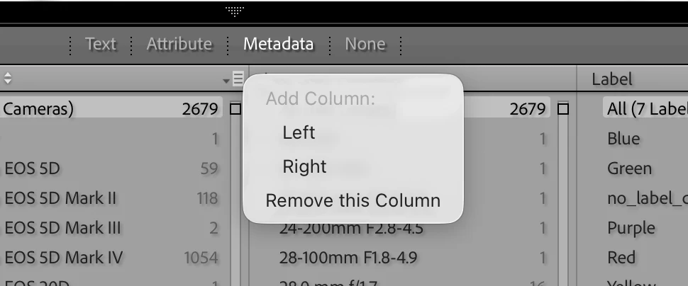

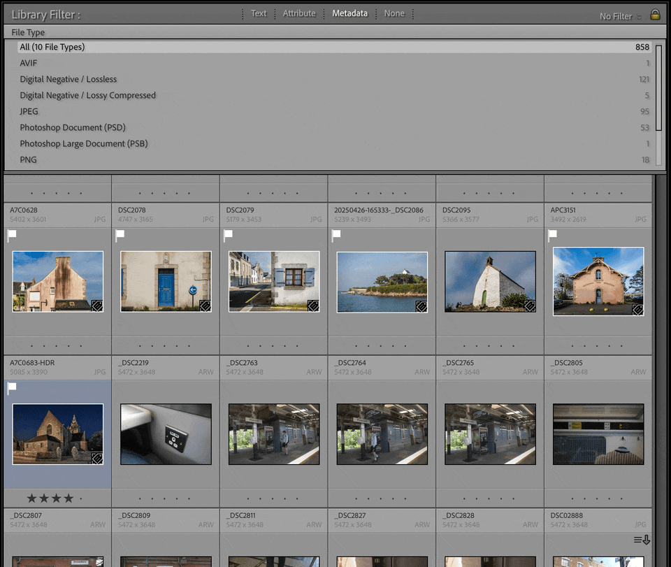

Rikk and Per already answered correctly, but if it’s still not clear, here is a demo of adding the column and filtering the list.
And yes, it can be confusing if you haven’t done it before, because there are controls at multiple levels of the Library Filter and also on the left and right side of the top of each column…you do have to move the mouse around a lot to click the correct tiny and hard-to-see control for each step. What can make this even more challenging is that the tiny drop-down arrow that lets you add or remove the column is visible only when the mouse is over the column header bar! So you might not see that arrow if you don’t already know it’s there.

Apr 22, 2026 3:03 PM UTC
Click on the down arrow in each column header to get an Add Column option.

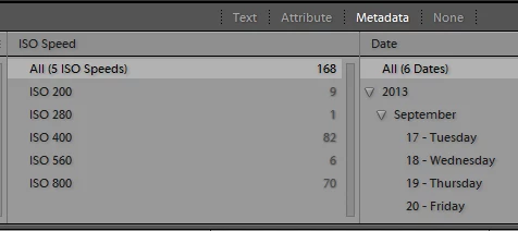

Per Berntsen
Sep 26, 2019 12:47 PM UTC
You can filter by ISO speed under Metadata in the filter bar.
If ISO doesn't show, click one of the column headings to get a menu where you can choose ISO.
Laura Shoe
Sep 26, 2019 6:35 PM UTC
If you're looking to filter on a range of ISOs, select multiple ISOs in this metadata filter that Per has posted - click on the first you want, then shift-click on the last, and all within the range will be selected.
