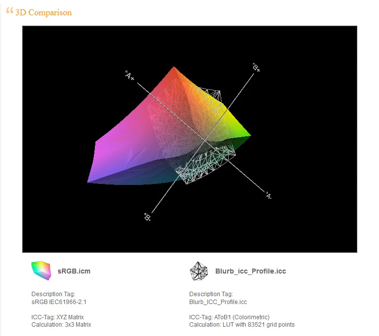

    Blurb suggests submitting books with sRGB profile images if not using PS or InDesign. The problem is that the smaller gamut Blurb.icc CMYK profile falls outside the sRGB color space in certain parts of the Yelllow, Green, and Blue spectrum, which effectively clips these colors when sending sRGB profiled images. How badly this affects the color in your images depends on the amount of area that actually falls into these clipped areas. But even with significant out of gamut areas the image may still look quite acceptable.
    It has already been established that a single profile (i.e. Blurb.icc) cannot represent the actual gamut of all the paper types Blurb offers, but using it should theoretically get more of your image into the actual printable color gamut. I use InDesign with the Blurb plugin and ProPhoto RGB workspace, which is converted to the Blurb.icc CMYK profile during PDF export. I haven't found it necessary to "correct" images based on soft-proof preview using the Blurb.icc profile and the printed book images have been remarkable close to what I see on my calibrated sRGB gamut monitor. Unfortunately I haven't used the LR Book module to compare the results using sRGB images, but I'm guessing it would be very close.
    The real problem is that's a bogus profile! It doesn't define their output. It's a generic CMYK profile based on GRACoL 2006, and further, we're expected to believe it's based on all the papers one can select? Again, unless one is supplied the actual ICC profile used to convert the RGB data, soft proofing and attempting to evaluate the output with a bogus profile is, well bogus <g>.
    I've measured all the papers Blurb provides, just the papers alone are not even close to GRACol 2006. In fact, the deltaE differences in just the two most different papers are nearly dE4! So you have a profile supplied (they actually say on their website it is GRACol 2009 <g>) that isn’t anything like any of their papers and worse, their papers are all over the place, full of OBA’s that don’t act anything alike.
    The alternative is for Blurb to simply supply the 4-5 actual profiles from the actual papers. Then there is the issue of soft proofing CMYK in Lightroom although there IS a possible solution that Steve Upton who writes ColorThink pointed out on the ColorSync list. Those users who have ColorThink Pro with the optional ColorCast module can "embed" the proofing effect of any ICC profile (RGB, CMYK, or more channels) INTO an existing RGB profile like AdobeRGB. That’s an expensive option and what we really need is for Adobe/Blurb to possibly licence this from CHROMIX and supply to all LR users. But it isn’t worthwhile until we have actual profiles for the actual print process.
    Lastly, if you compare even the GRACol profile to sRGB which is uploaded to Blurb, you see a significant amount of out of gamut blues, teals and some yellows that sRGB can’t contain as you've correctly pointed out. IOW, sRGB to Blurb isn’t ideal. Adobe RGB would be much better with still a tiny amount of OOG if we believe that the GRACol aim is valid for Blurb.
