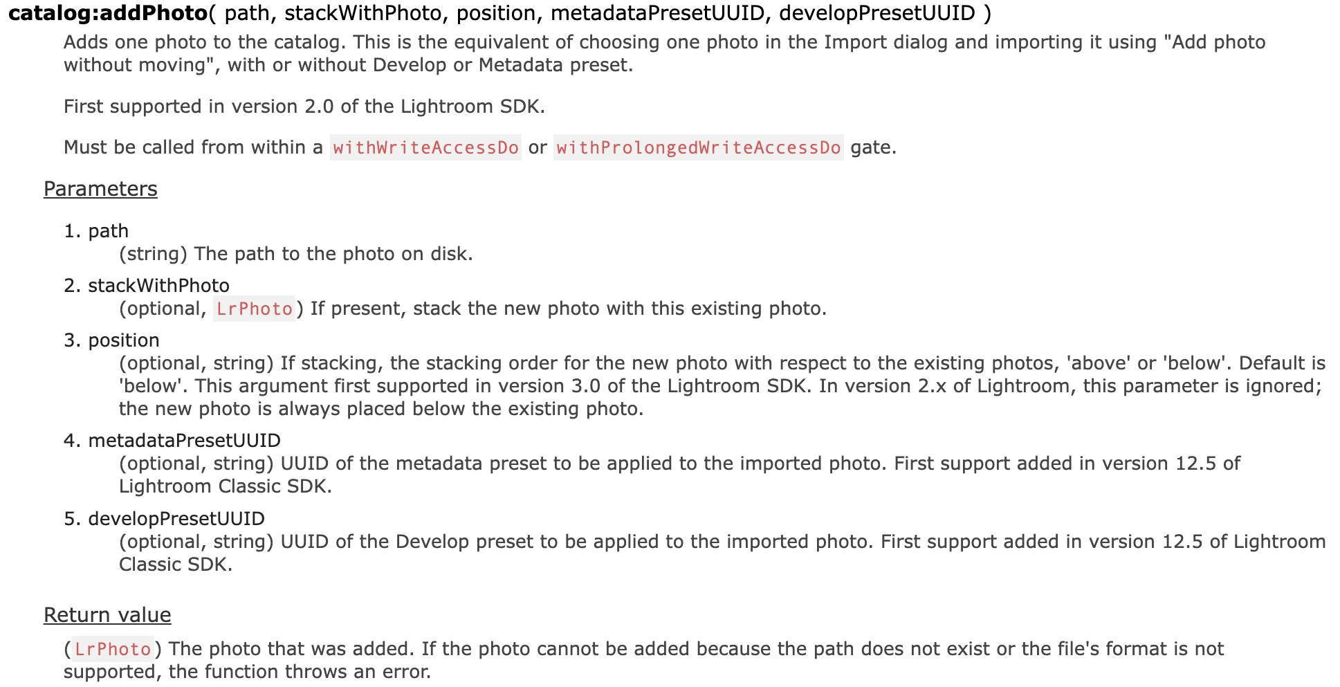

Not surpisingly, Dxo support, like most technical support much of the time, is wrong. It would be trivial for Dxo to modify their plugin to add the new DNGs to the top of the stacks rather than the bottom.
Details:
Looking at Dxo's documentation and the free trial I just downloaded, the Export option works via an Export preset provided by Dxo, which invokes an export service provided by the Dxo plugin, handing off the exported file to the Dxo program. It appears that both that export service and the alternative way of invoking Dxo via File > Plug-in Extras > Dxo Pureraw 4 use the plugin
DxOPureRawv4.import.lrplugin to import the DNGs back into the catalog.
Some quick examination verifies that plugin calls the LR SDK's method catalog:addPhoto() to import the DNG into the catalog. The addPhoto() method has a parameter "position" specifying whether the photo should be stacked on top or the bottom. See the documentation below.
Feel free to forward this to Dxo support. If you do, ask them to send me an address where I can mail my invoice for the free consulting 😆
