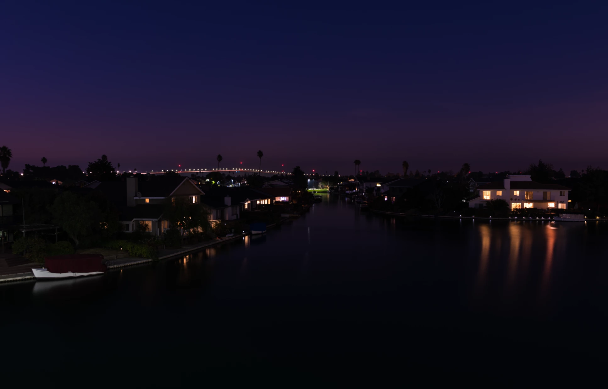

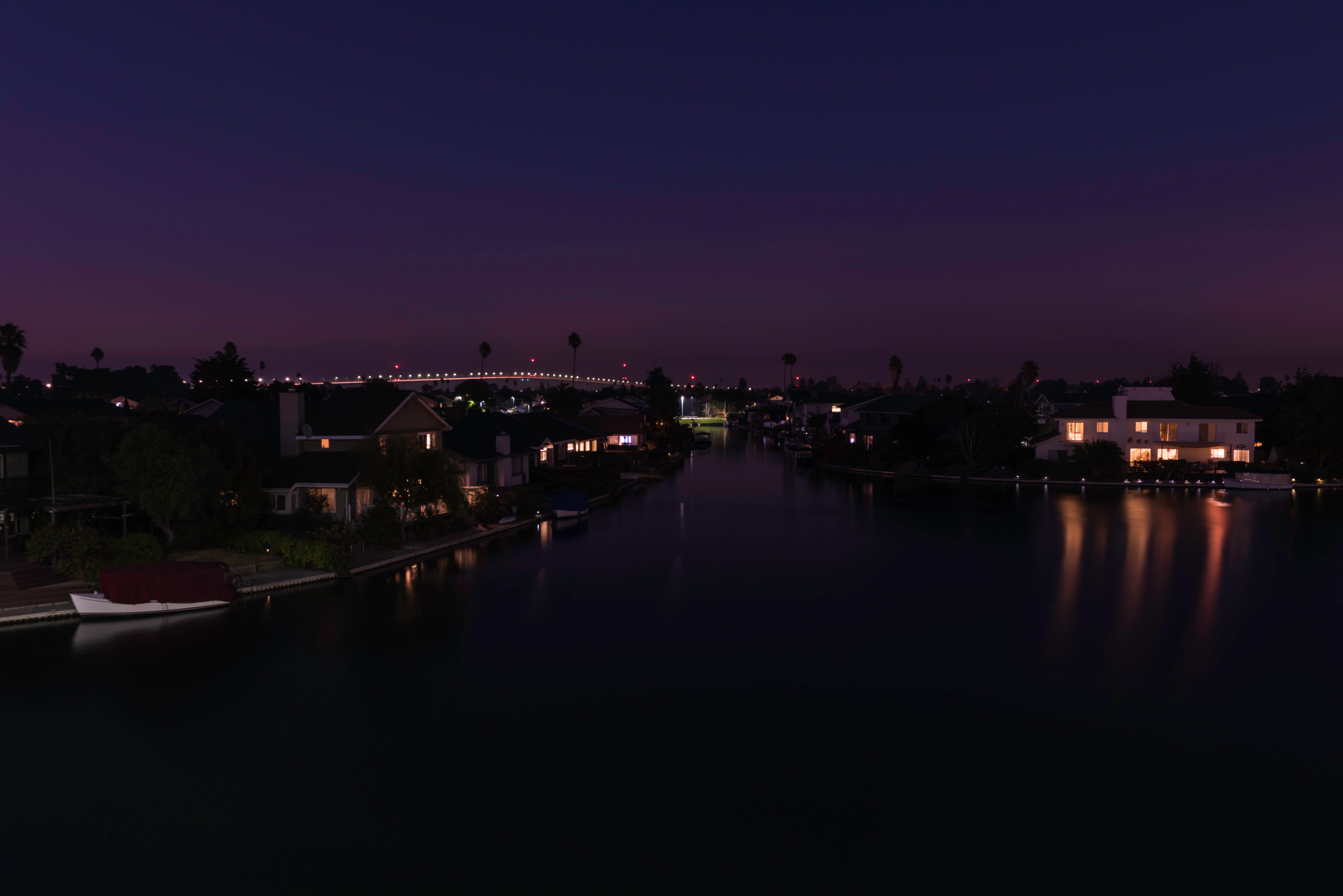

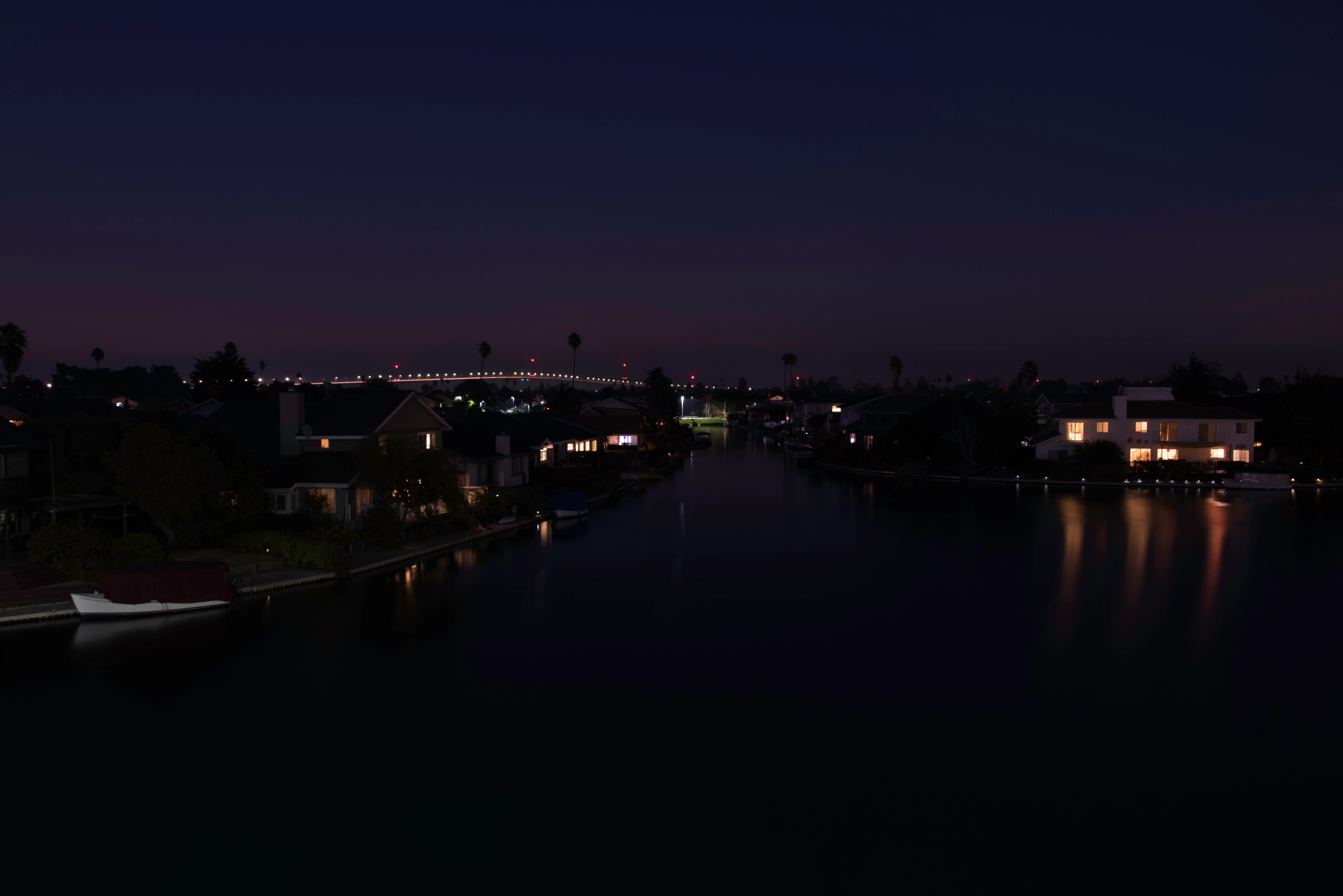

I'm including a number of versions of one image to illustrate the problem.
   Unprocessed RAW File Exported To 100% JPEG           Processed Lightroom File Exported to 100% JPEG
   Processed Photoshop File Exported to 100% JPEG     (Screenshot) Processed PS File Exported to TIFF
   Other Image (Banding In Upper Left)

Make sure you view the jpeg in Lightroom or Photoshop. Windows is very spotty in its color management and many apps aren't. Does the image show banding in Photoshop or Lightroom too? You shouldn't need quality 100 (which is still a lossy compression by the way) to get rid of banding. Banding is a very common issue in jpeg compression. Do note that both flickr and google photos recompress your images. Both are known to be very aggressive and will cause banding in many cases.
Like trshaner, I see only a little banding  on the exported files you have up in the first post but it is very obvious in the flickr and google photos screenshot. I use a high quality 10-bits display that is completely calibrated so I would see it if it is there. I do see some one-bit steps in the sky which cannot be avoided since you are using prophotoRGB as export space. prophotoRGB is an extremely wide gamut color space and 8-bits is sometimes not enough precision to avoid banding. In this case, if you want to go to the web, you really should be using sRGB which will have this problem a bit less. Also, quality 80-85 is almost always more than good enough to avoid any banding due to the compression algorithm.
Conclusion: use sRGB as your export color space and you only need about quality 85. Using sRGB will probably solve most of your banding issues.

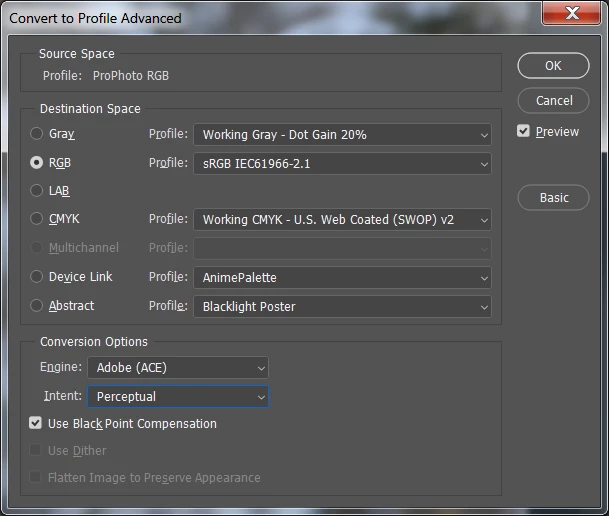

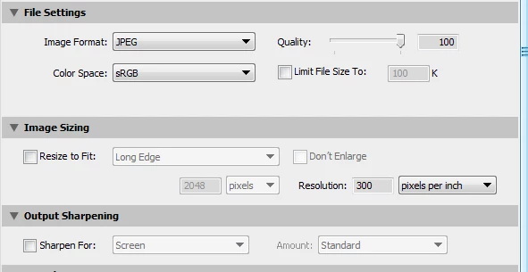

Try exporting the file with the settings you used that exhibit banding to DNG file format as shown below. Next open the DNG file in Camera Raw, which should now show all of the settings you applied inside LR. DO NOT CHANGE ANY OF THE SETTINGS INSIDE CAMERA RAW. Next select 'Open Image' at the bottom of the Camera Raw window. From the PS menu go to Edit> Convert to Profile and select 'sRGB' profile and Intent> Perceptual as shown below. Save the file to JPEG format with Quality 12.
Compare this JPEG to a JPEG exported from LR using the same DNG file with Quality 100, sRGB color space, NO 'Resize to Fit,' and NO 'Output Sharpening as shown below.
