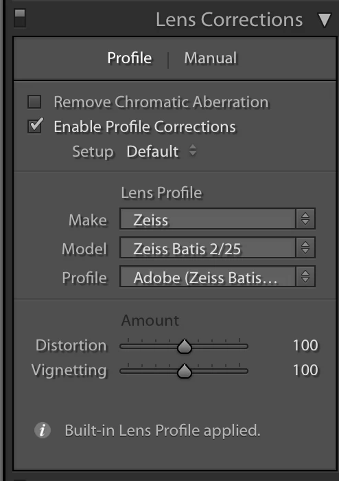

Does anyone know why adjusting the parameters in the Lens Correction Panel would make Lightroom suddenly choose to using an alternate (and incorrect) profile? Maybe just a bug?

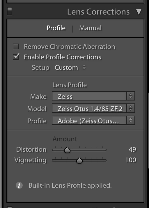

Lens profile enabled. I click 'Setup: Default' and the correct profile loads, I then move either the distortion or vignetting slider and the incorrect profile is loaded. I took a screen reocrding but don't seem to be able to add it here.
These are regular DNG files, converted from ARW with Lightroom, not EXIF tweaked in any way. They have completely stadard metadata. Lightroom correctly identifies the camera and lenses in various metadata fields. Sony A7RII. The problem exists with a variety of Sony lenses (Batis, Sony G etc). The option to reset my lens profiles to defaults is greyed out, I guess that means that they are reset. I also emptied out the LensProfileDefaults folder to make sure that nothing odd had ended up set. No change.

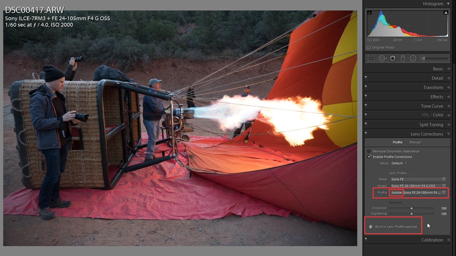

When it says that a built-in lens profile is applied, you should not select another lens as what will happen is that you get lens corrections applied doubly. For some cameras Adobe made the bad decision to always apply lens corrections. You cannot turn them off. I did not think this happens to files from Sony A7RII cameras though. I know it happens to my Z7 files.
https://feedback.photoshop.com/photoshop_family/topics/disable-built-in-lens-profile
