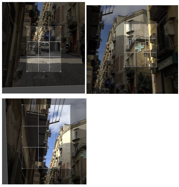

Here's four different shaped, different positioned crops from the same photo:

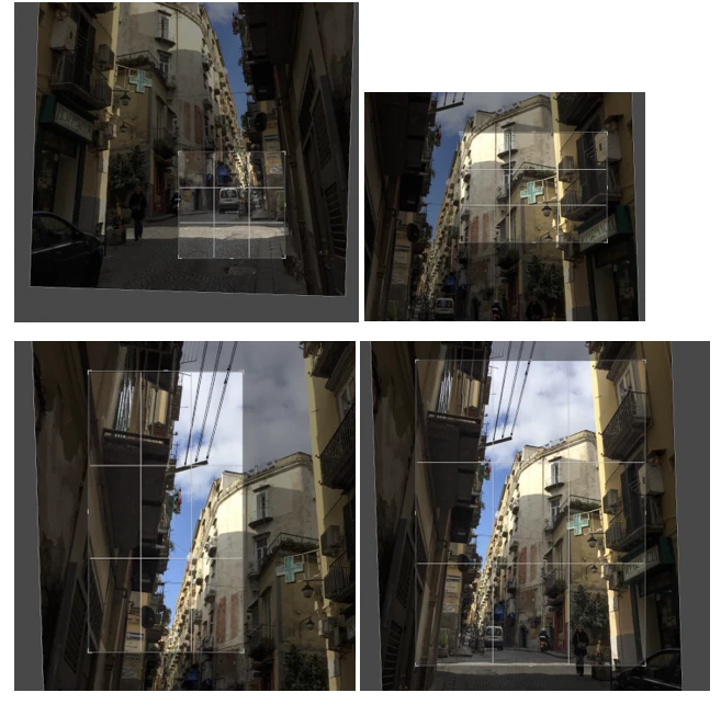

and here are versions 1, 2 and 3 again, after syncing onto those just the aspect ratio from crop 4:
One way to do this is using a selective option in Sync or in Copy/Paste Settings;
another method: after adjusting or choosing an aspect rato on one image, you can hit Shift+A on some other image and it will adopt that same remembered aspect ratio for its own crop - while still preserving the centring and sizing it had before.
