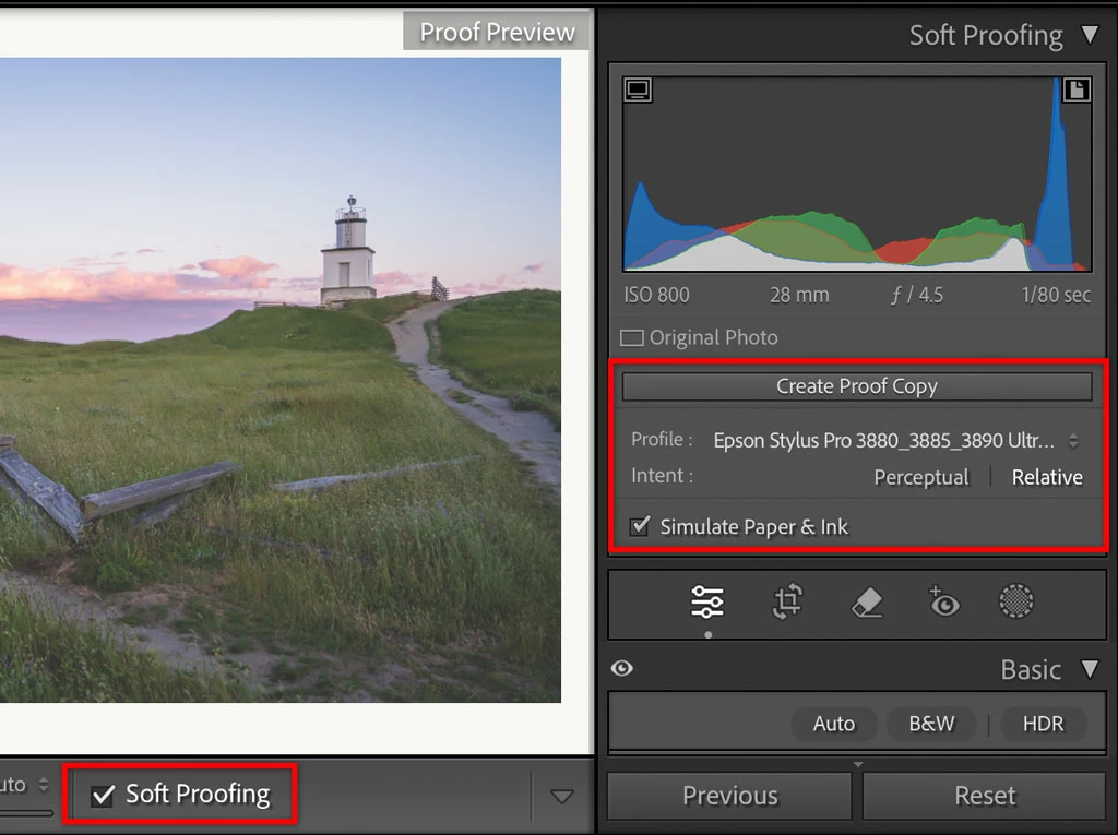

In Lightroom Classic and other print-friendly Adobe apps, this can be done by soft-proofing in the Develop module. Soft-proofing means making the screen simulate the colors and tones that are achievable with a specific combination of printer, ink, and paper.
1. In the Develop module, if the toolbar is visible, enable Soft Proofing. This is a shortcut for choosing the menu command View > Soft Proofing > Show Proof.
2. In the Soft Proofing section that appears under the histogram, click the Profile menu and select the printer/paper/ink profile you intend to select later in the Print module. If that profile is not in the list, in the menu choose Other, and add the profile. In my example below, I selected a profile to simulate what the image might look like on an Epson 3880 using Epson Ultrasmooth paper, which uses the printer’s matte ink set.
3. Set the options Intent and Simulate Paper & Ink as needed. It’s typical to select the Relative (Colorimetric) intent and enable Simulate Paper & Ink.
The image will probably dull down a little, but that’s because it’s telling the truth about how the capabilities of that particular combination of printer+ink+paper. For example, a cheap matte paper will reproduce less color and contrast than a higher-priced glossy paper, and soft-proofing simulations will show that to you before you print.
If you make any edits at this point, you’ll be asked if you want to make a proof copy, or you can do it yourself by clicking Create Proof Copy. This makes a virtual copy of the image that saves any edits specific to this printer/ink/paper combination, without limiting the original. So you can save separate proof copies of the same image, tailored to different media types.

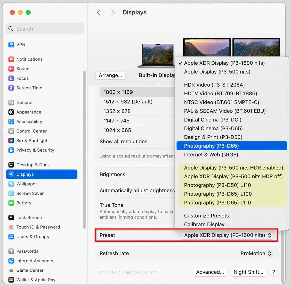

Because you have a 14"/16" MacBook Pro, you can take this one step further if you want, because it has the Apple Liquid Retina XDR Display. This is an excellent display that is well calibrated out of the factory (one of the best available for a laptop), but as I said, the default display preset of Apple XDR Display (P3-1600 nits) color and tone capabilities far exceed what any printer can reproduce. So you may want to try choosing a more print-relevant calibration preset. In macOS System Settings > Displays, you can pick a display Reference Mode Preset such as Photography (P3-D65) or Design & Print (P3-D50). This sets the white point to a graphic arts standard, and also limits luminance to a more paper-like 160 nits instead of (unachievable on paper) 1600 nits.
The yellow area highlights presets that I made, so they don’t come with your Mac. I customized them for the printing conditions that I wanted to account for, such as certain white points and maximum luminance limits (many print pros like to calibrate their display to between 90-120 nits). If you want to read more about the Reference Mode Presets, here are the Apple articles about it:
